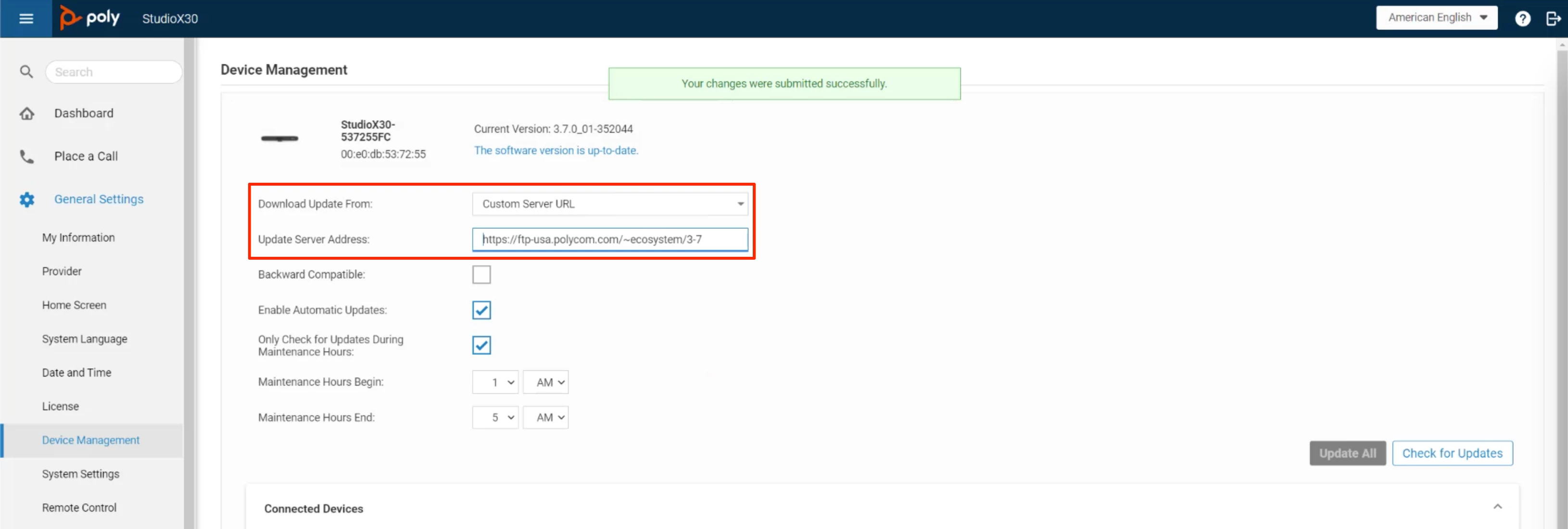

  1. Enter the Poly device IP address in your web browser, and enter your device credentials to access the Poly dashboard.
  2. On the Poly dashboard, click General Settings > Device Management tab from the side-panel menu.
  3. Ensure the Poly device firmware has been updated to the latest Appspace supported version.
  4. To update the Poly device firmware, select Custom Server URL from the Download Update From drop-down menu, and enter the server URL that hosts the latest firmware update.
  5. Click Update All to download and update the device firmware.
  6. Once done, proceed to enable Digital Signage on the device.

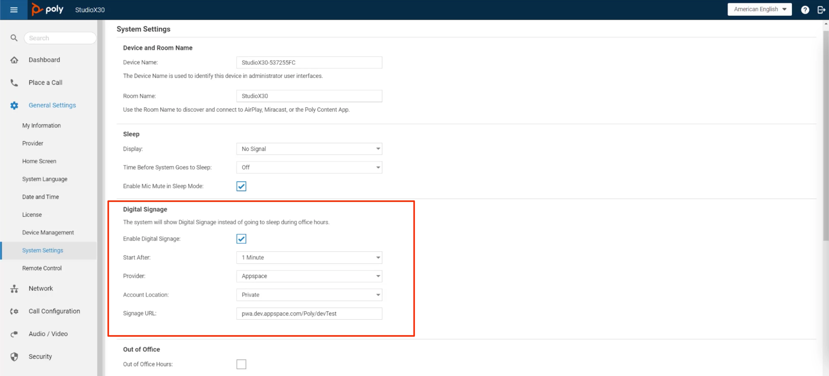

  2. On the Poly dashboard, click General Settings > System Settings tab from the side-panel menu.
  3. In the Digital Signage section, check the Enable Digital Signage checkbox to configure the following settings:
    • Start After – Select the duration from the drop-down menu, to determine when digital signage is displayed once the device is idle.
    • Provider – Select Appspace from the drop-down menu.
    • Account Location – Select Private from the drop-down menu.
    • Signage URL – Enter one of the following Appspace App PWA URLs in the Digital Signage URL field, depending on your Appspace deployment:
      • Appspace Public Cloud:
        • https://cloud.appspace.com/app/?registrationmode=passive
      • Appspace Private Cloud:
        • https://<customer>.cloud.appspace.com/app/pwa/?registrationmode=passive
  4. Once done, click Save.
  5. Once successfully connected, the Appspace App device registration page is displayed. Follow the instructions in the Register a device article (from Step 2 onwards) to register your device.When choosing the Channel selection mode, select the following option only:
