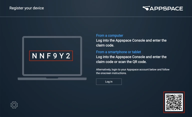

  2. Launch the Appspace App. The device registration page will be displayed.

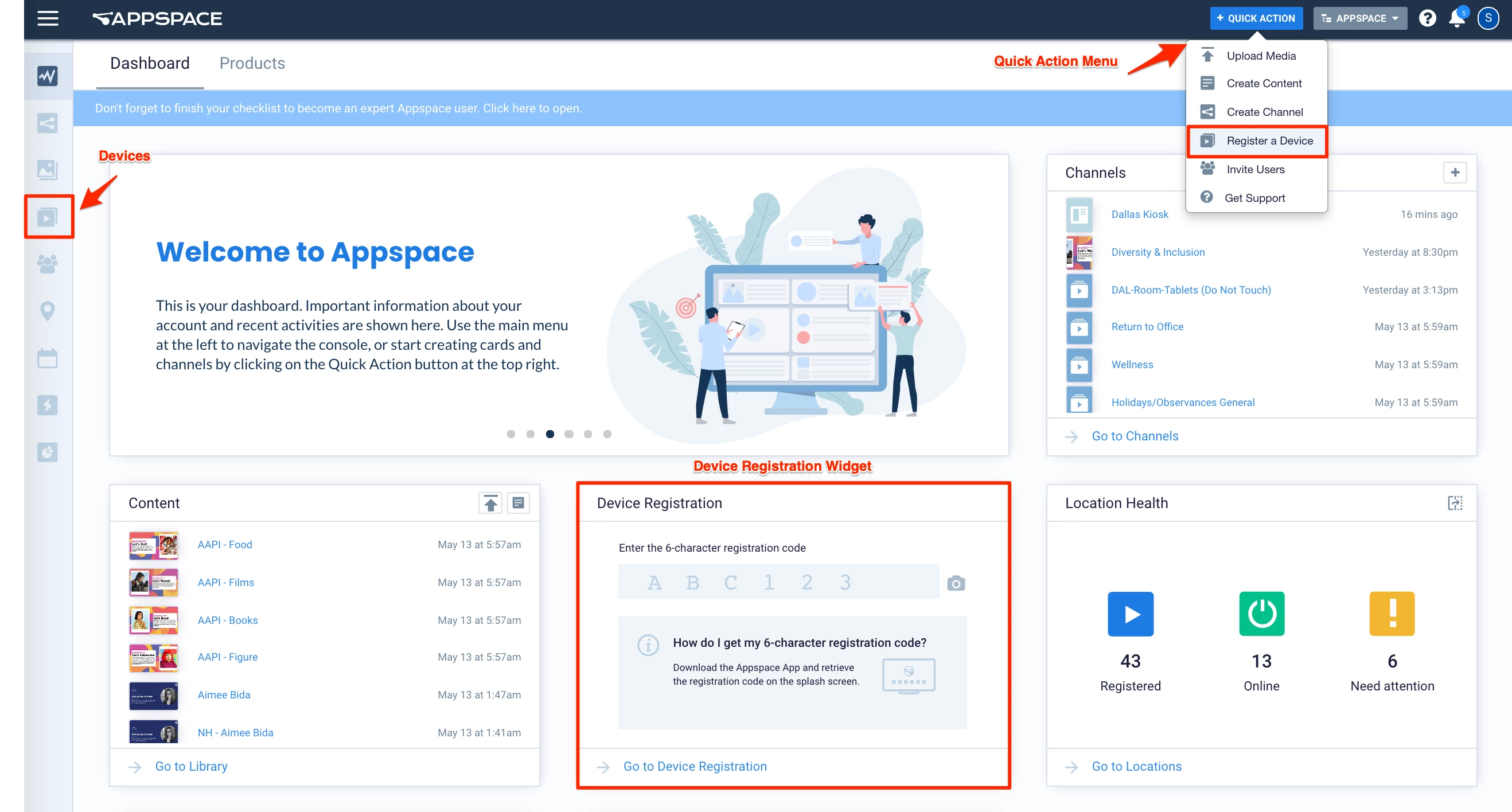

  3. Log in to the Appspace console and launch the device registration page via one of the following methods:
    • Click the QUICK ACTION menu and select Register a Device.
    • Go to the Device Registration widget on the Dashboard.
    • Click the ☰ Appspace menu, select Devices, and click the Add button in the Devices tab.

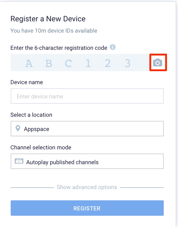

  4. In the Register a New Device window, choose one of the following methods:

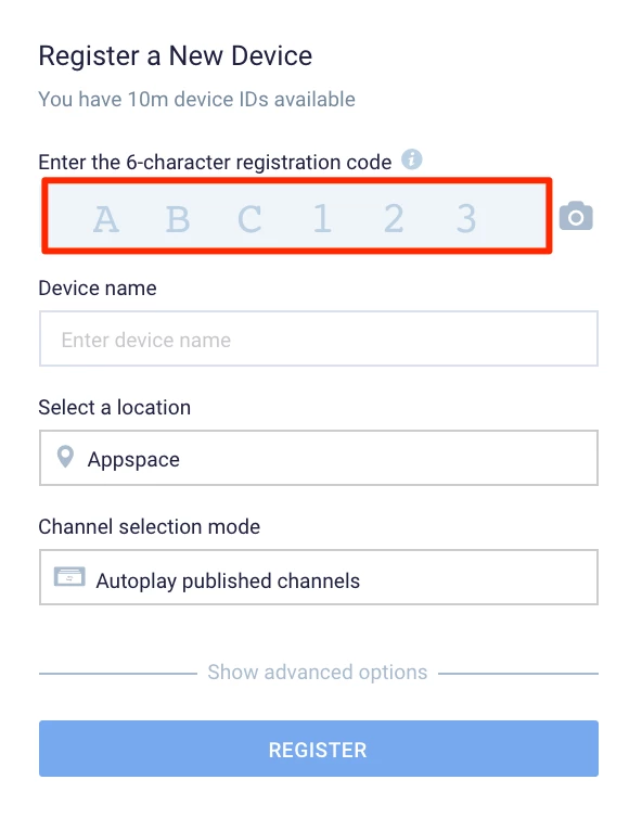

    •  Using the 6-character registration code:
      1. Enter-in the 6-character registration code displayed on the Appspace App device registration screen.
      2. Go to Step 5 below.

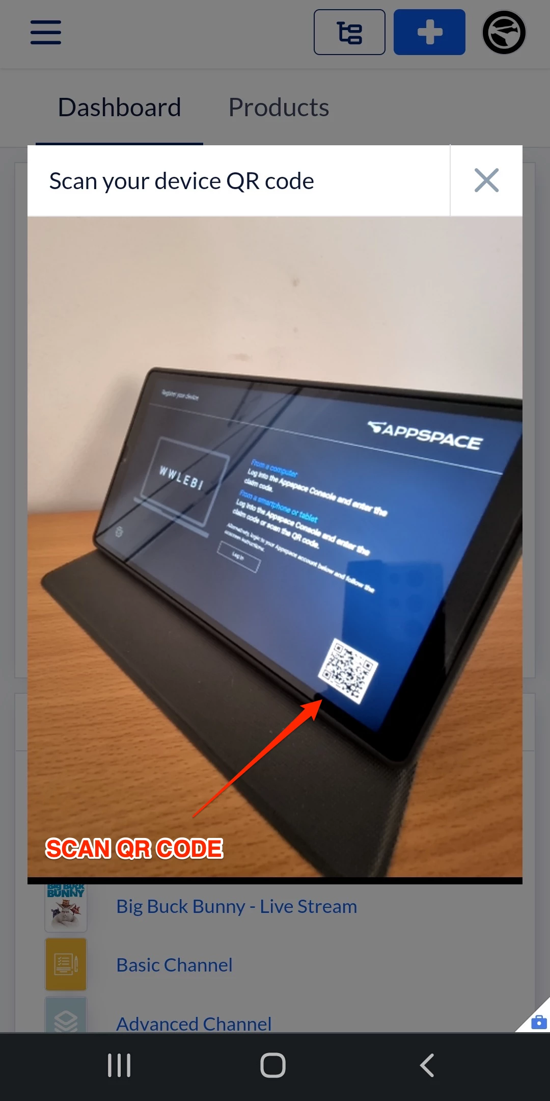

    • Using the QR code:
      1. Click the camera icon to launch the QR code scanner.
        On first use, you need to allow the QR code scanner to access the camera, by clicking the Allow button in the request window.
      2. Point the QR code scanner to the QR code on the Appspace App device splash screen. Once the QR code is in view, and scan is successful, you are returned to the Register a New Device window once again.
      3. Proceed to Step 5 below.
  5. Back in the Register a New Device window, enter the Device name and select a location. If a location has not been created, you may skip this step and assign a location later.

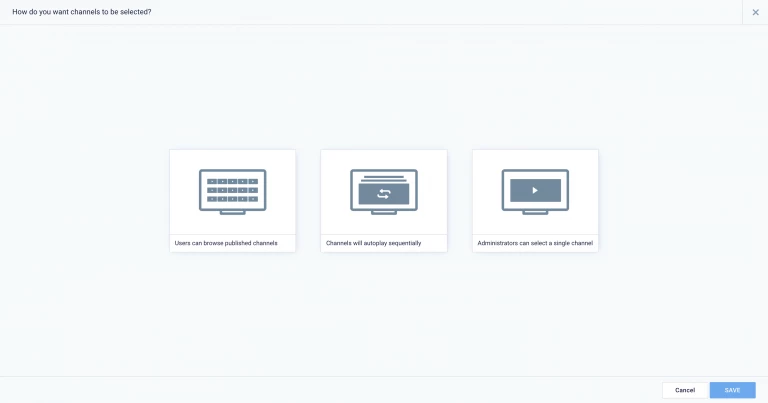

  6.  In the Channel selection mode field, select one of these playback options and assign a channel (if already created):
    • Users browse published channels – this is the interactive mode or channel browsing mode, ideal for touch screen TVs or TVs with remote control, to display corporate content and enterprise tv, in any common space. When displaying the channel browsing mode, anyone can browse and play any content published to this device.While a Location Admin configures this setting, a Publisher must publish channels to the device and may assign any type of content, and channel type.
    • Autoplay published channels – when this option is selected, one or more channels will autoplay on the device. This option is ideal for wallpaper displays in collaboration devices, video walls, interactive billboards, and any other workplace or public space signage needs. No user interaction is needed. Content is displayed according to scheduling or dayparting settings.While a Location Admin configures this setting, a Publisher must publish channels to the device and configure the scheduling settings. This option is currently available only for playlist channels.
    • Administrators can select a single channel – this option displays only one channel, with any type of content, and channel type (playlist channel, an advanced channel, or a live channel). It is ideal for information kiosks, POS systems, bulletin boards, room scheduling, and simple signage.The Location Admin who registers the device is able to assign one single channel directly during this configuration. However, to select a channel here, the channel must already be created prior to this registration. If the channel has not been created, you may skip this step, and you (Location Admin) or a Publisher may assign a channel later.
