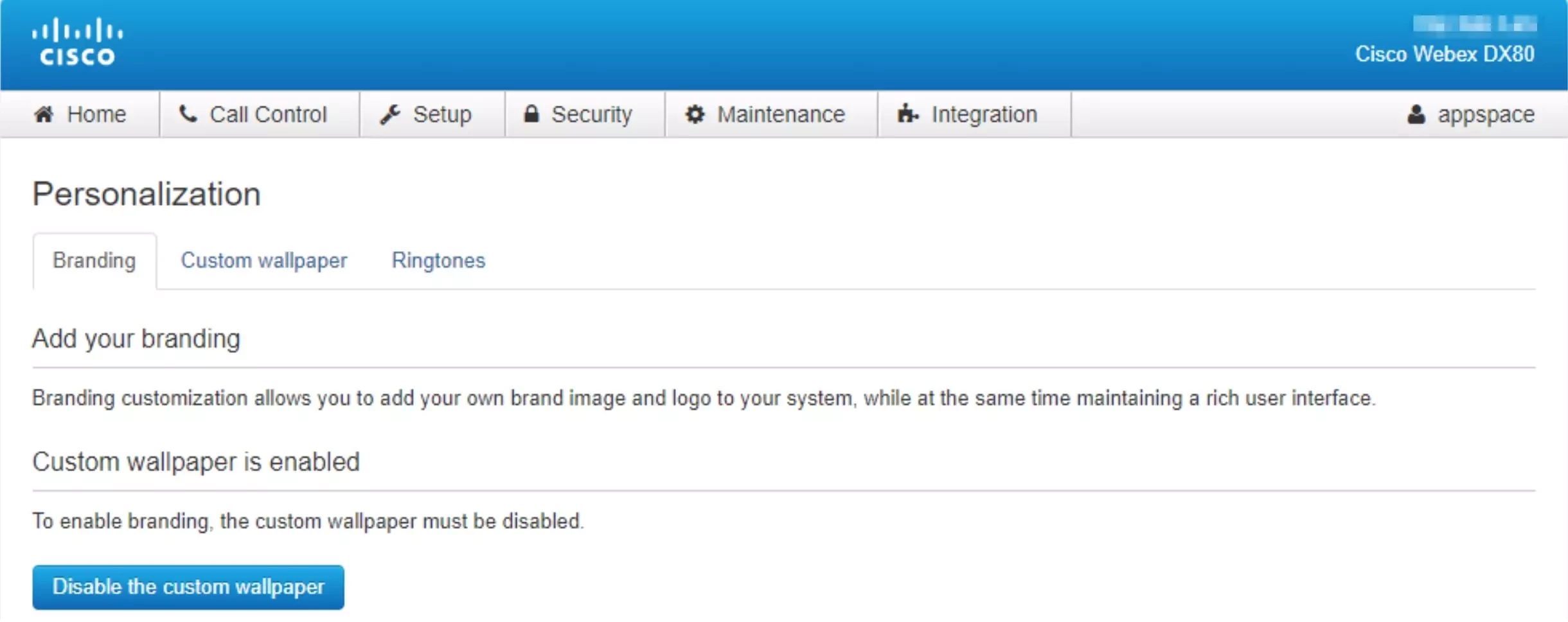

  • Ensure Cisco CE devices are configured to enable Custom Wallpaper, while Branding is disabled, as both these features are unable to co-exist together.
    You can disable the Branding feature via Setup > Personalization on the Cisco CE device.

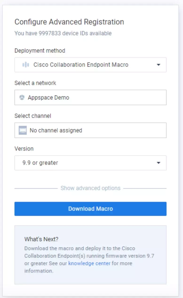

  1. Log in to your Appspace account, and click Devices from the Appspace menu.
  2. In the Devices tab, click ADD, and click the advanced device registration link.
  3. Select Cisco Collaboration Endpoint Macro from the Deployment method drop-down menu, and select the desired network.
  4. In the Channel selection mode field, select one of these playback options and assign a channel (if already created) that will be displayed as the wallpaper for the Cisco CE device:
    • Administrators can select a single channel – ideal for signage, you may select either a playlist channel, an advanced channel, or a live channel. However, to select a channel here, the channel must already be created prior to this registration. If the channel has not been created, you may skip this step and assign a channel later.
  5. Select Version 9.9 or greater from the drop-down menu.
  6. Click the Show advanced options link, to configure the Device Description, Device Group, and, Device Tags.
  7. Click Download Macro to download the macro.js file to a default download folder in your local machine.

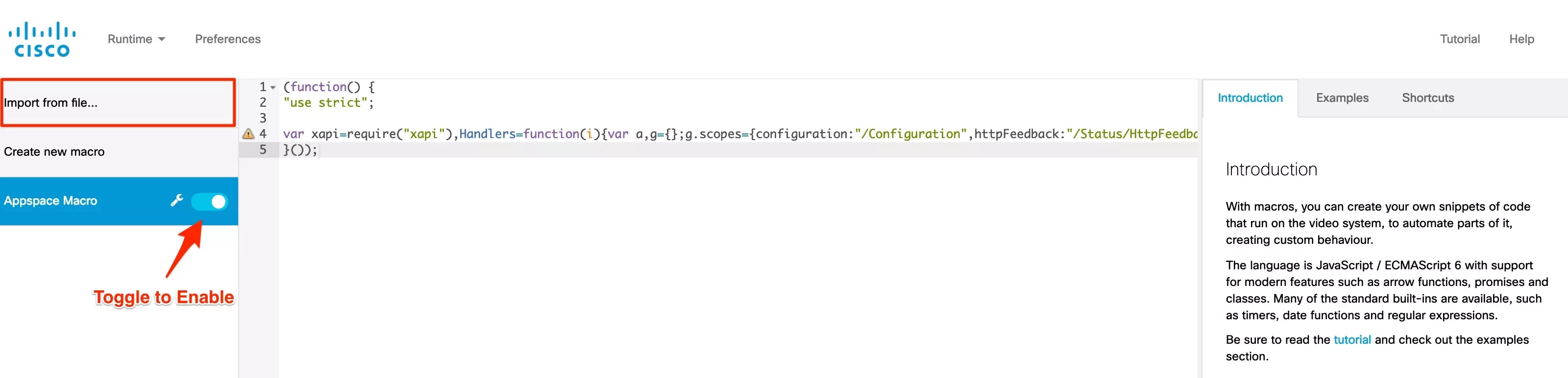

  1. Log in to your Cisco Collaboration Endpoint (CE) device’s web interface (via device IP address) with your Cisco Admin credentials, and navigate to Integration > Macro Editor.
  2. Click Import from file to import the downloaded macro.js file.
  3. Save, and enable the macro entry via the toggle.
  4. To verify if the macro has been deployed correctly, click Show History, and the message “successfully sent Http Post” should indicate the Cisco CE device is able to reach out to the Appspace server.
