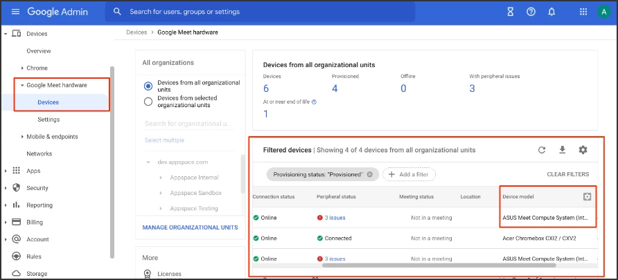

  1. Log in to your Google Admin console.
  2. On the left panel, go to Devices > Google Meet hardware > Devices.
    Your Google Meet device must be first configured with Chrome Device Management via Chrome Enterprise. Refer to the instructions in the Enroll your device article.
  3. The enrolled device will be listed under the Filtered devices section.

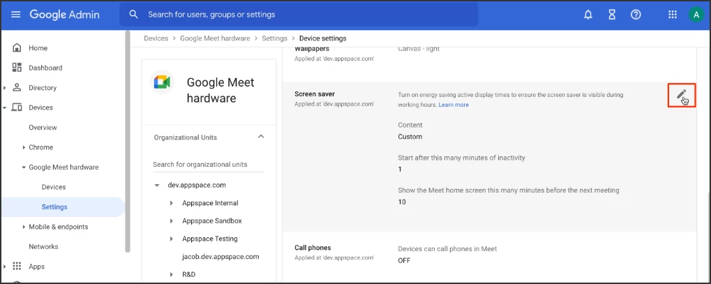

  4. On the left panel, click Google Meet hardware > Settings.
  5. Under the Devices settings section, scroll down to the Screen saver section.
  6. Click the pencil icon next to Screen saver.

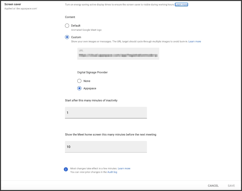

  7. Under Content, select the Custom option.
  8. Input one of the following Appspace App PWA URLs in the Custom > URL field, depending on your Appspace deployment:
    • Appspace Public Cloud:
      • https://cloud.appspace.com/app/?registrationmode=passive
    • Appspace Private Cloud:
      • https://<customer>.cloud.appspace.com/app/pwa/?registrationmode=passive
        To start the Appspace App content seamlessly without displaying the Appspace splash screen — including the "device is in streaming mode" notice — use the following URL instead:
        https://cloud.appspace.com/app?skipsplash=true
  9. Under Digital Signage Provider, select Appspace.
  10. Input in minutes in the Start after this many minutes of inactivity field. This option determines when the screensaver should start playing after the device has been idle
  11. Input in minutes in the Show the Meet home screen this many minutes before the next meeting. This option determines when the screensaver should stop playing and display the Google Meet home screen before the next meeting starts.

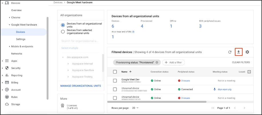

  3. In the Filtered devices section, click the download icon.

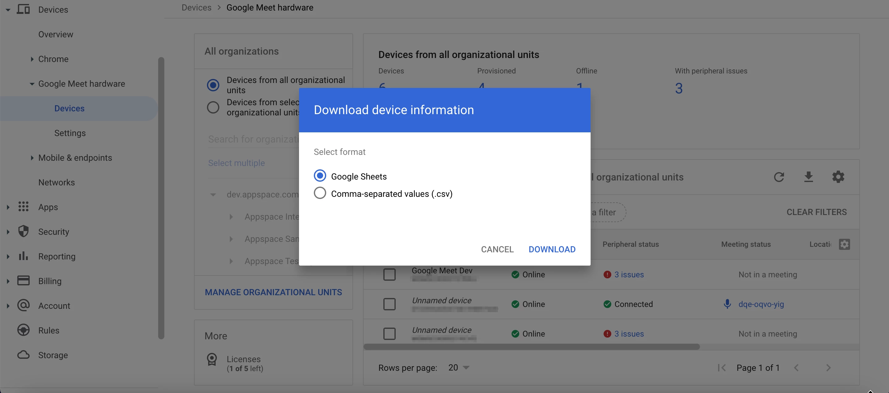

  4. Select the desired file format to be downloaded in the Download device information section, and click Download.

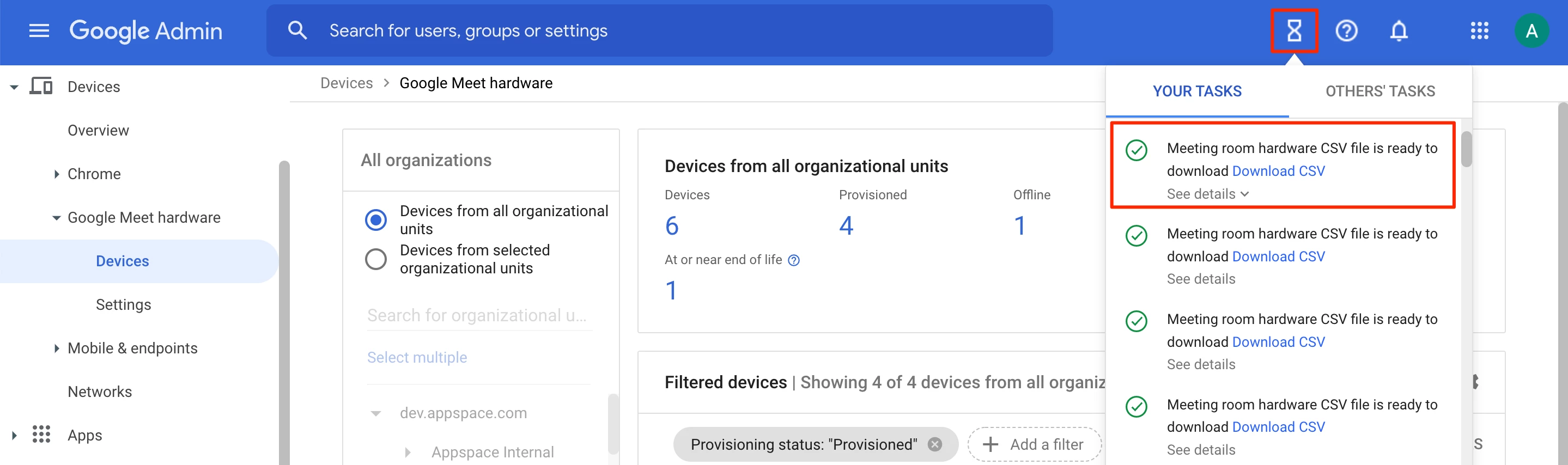

  5. Once completed, select Task > Download CSV to view the CSV file.
  6. In the CSV file, search for integrationId column to get the Google Meet device serial number.
