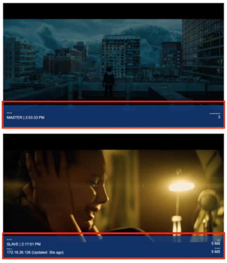

Enable Debug Mode for Synchronized Playback
In order to debug synchronized playback on video walls, add the following device property to both Controller and Worker devices:
Device Property Value Description / Example
player.clocksync.debug true –
Once debug mode has been enabled on both Controller and Worker devices, the debug layer will appear if all devices are in sync, switching between four colors (purple, blue, green, black). The debug layer also displays the following information:
  • Device time.
  • Identify if the device is a Controller or Worker.
  • The delta (differential) sync between the Controller and Worker devices.
  • The round-trip between the Controller and Worker devices.
  • The last updated delta sync and round-trip between the Controller and Worker devices. If the round-trip between devices is larger than 0.5 seconds, the device will show as offline.
  • The Controller device will display the number of Worker devices that are connected to it.
  • The Worker device will display the IP address of the Controller device it is connected to.
