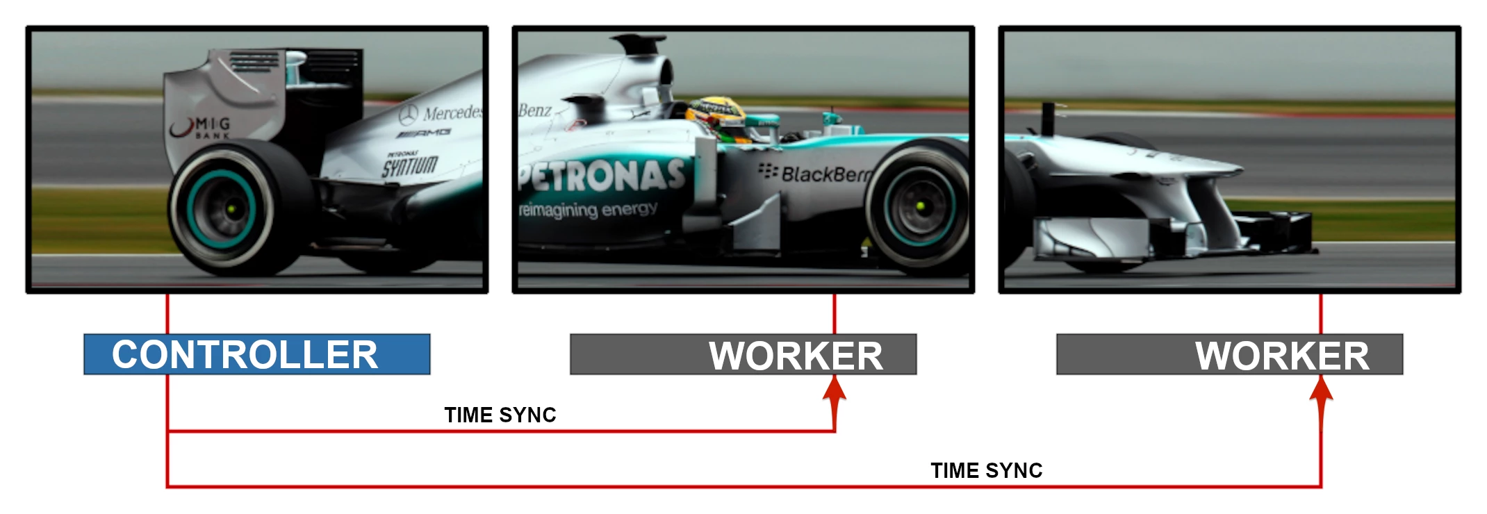

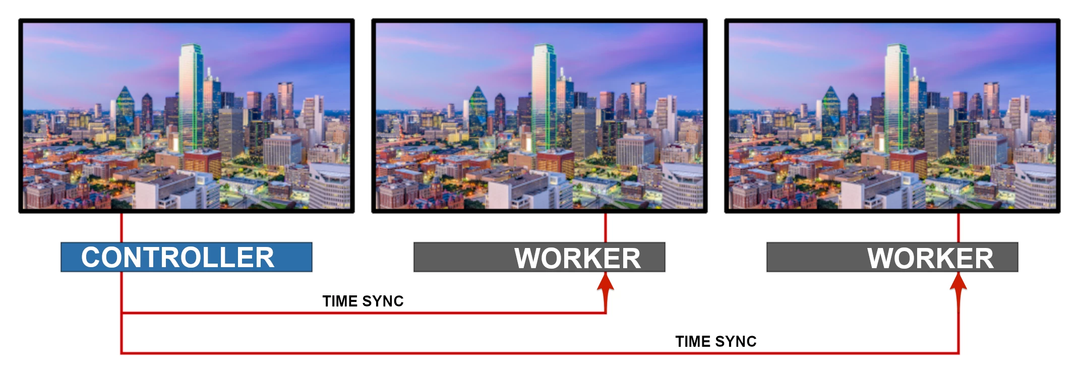

As we have mentioned, this is a multi-player approach where each display of the multi-screen or video wall has a media player connected to it. With this configuration, one of the media players acts as a controller and timekeeper, while other media players act as worker devices. Through the network, worker devices check what content frame they should be showing, and adjust their playback to sync with the controller. The worker also accounts for the network latency of making this call to the controller. When used in video walls, Appspace splits the video channel into tiles, and each device plays the appropriate tile forming a video wall. As there are no limitations on the number of worker devices, the size of the video wall can adapt to the deployment needs by simply adding more devices.

The primary challenge with distributed, synchronized video playback is accurately synchronizing the clocks on each of the individual devices. It’s important that playback begins at the same millisecond and remains in sync throughout video playback. There are many approaches for synchronizing clocks, we follow a controller-worker pattern.
Our clock synchronization method nominates a device to act as the controller timekeeper. The other devices adjust their clock to synchronize with the controller device’s time to the millisecond. To do this, a millisecond offset from the controller is calculated and then used by the worker to adjust the time.

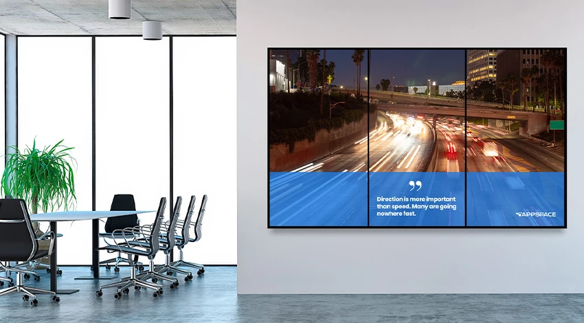

Video Tile Mapping
Tile mapping divides content into multiple tiles pieces, known as “tiles”, and maps a screen to each tile. Appspace has enhanced our tile mapping methods to work with clock synchronization technology, which can then ensure content in each tile is perfectly synchronized. This approach can scale to a large number of devices, removing the dependence on a centralized device’s maximum output.

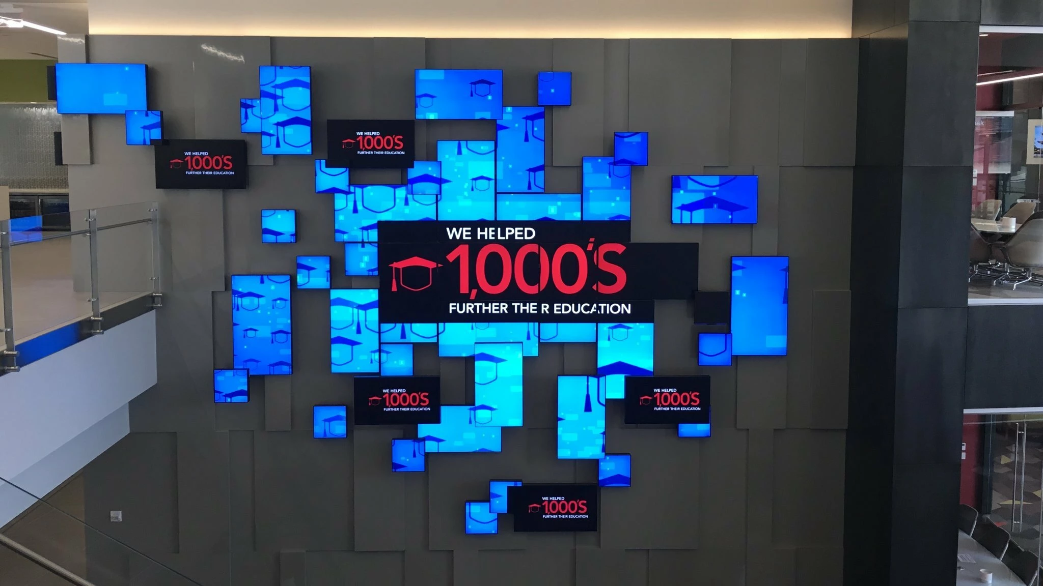

A mixture of video walls and distributed screens turn rooms, walls, and spaces into a powerful messaging medium. For example, a multiple-located entity can have a video wall in its reception and several other screens distributed in each location. In the morning, these screens play 30-minute news and weather reports. Throughout the day, the video wall plays an eye-catching video of the organization’s brand to visitors.
Meanwhile, the distributed screens play different content specific to the interests of the people in the space. In the evening, the screens play a traffic report benefiting those leaving the location. Once a month, the distributed screens present town hall videos at a scheduled time, recapping the session for attendees and those who missed the event.
