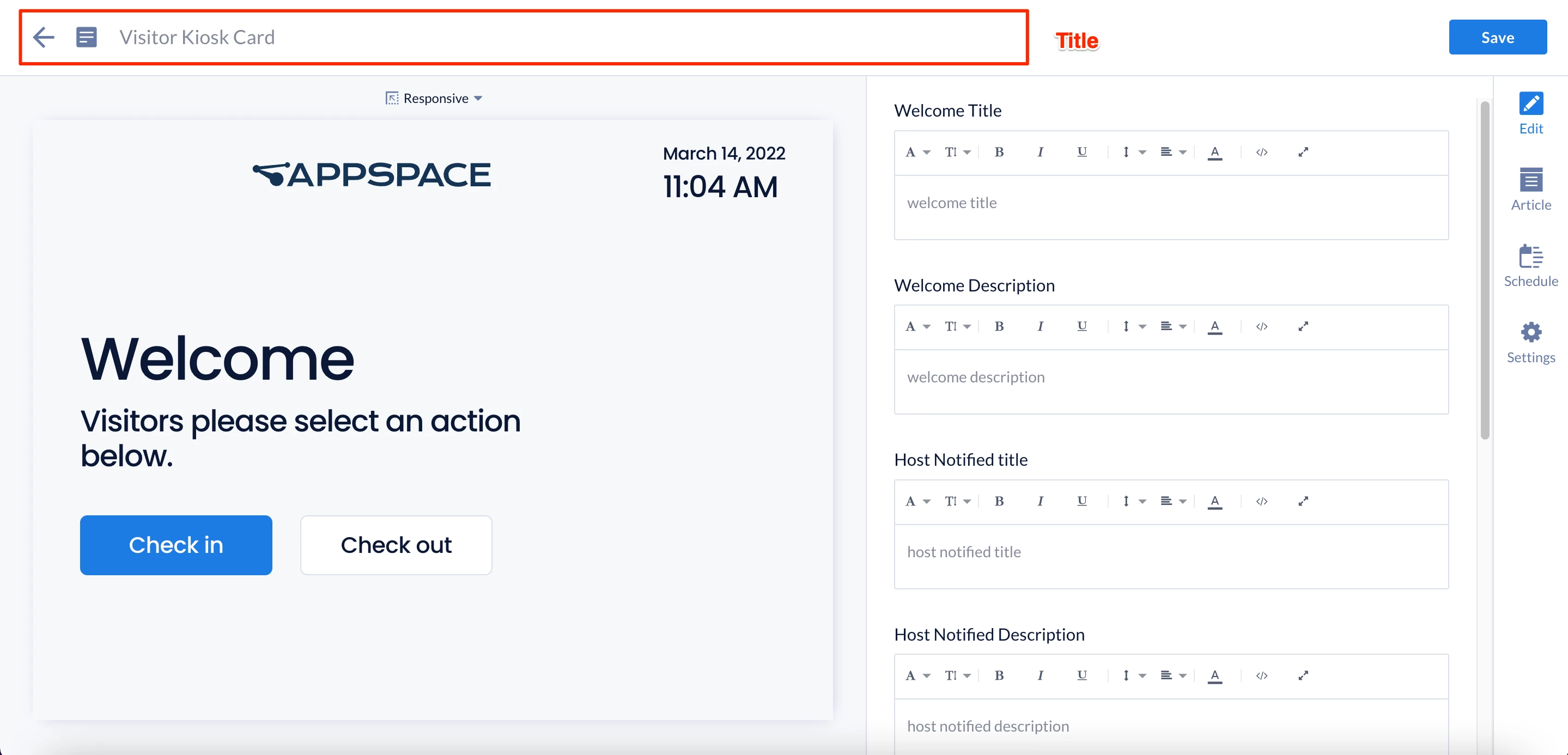

  3. Select Workplace from the All Templates panel, and click Visitor Kiosk Card.
  5. In the Edit tab, you may configure the following:
    • Change the card’s default text in the following areas:
      • Welcome Title, Welcome Description, Host Notified title, Host Notified Description, Checkin Title, Checkin Description, Checkout Title (New) and Checkout Description (New).

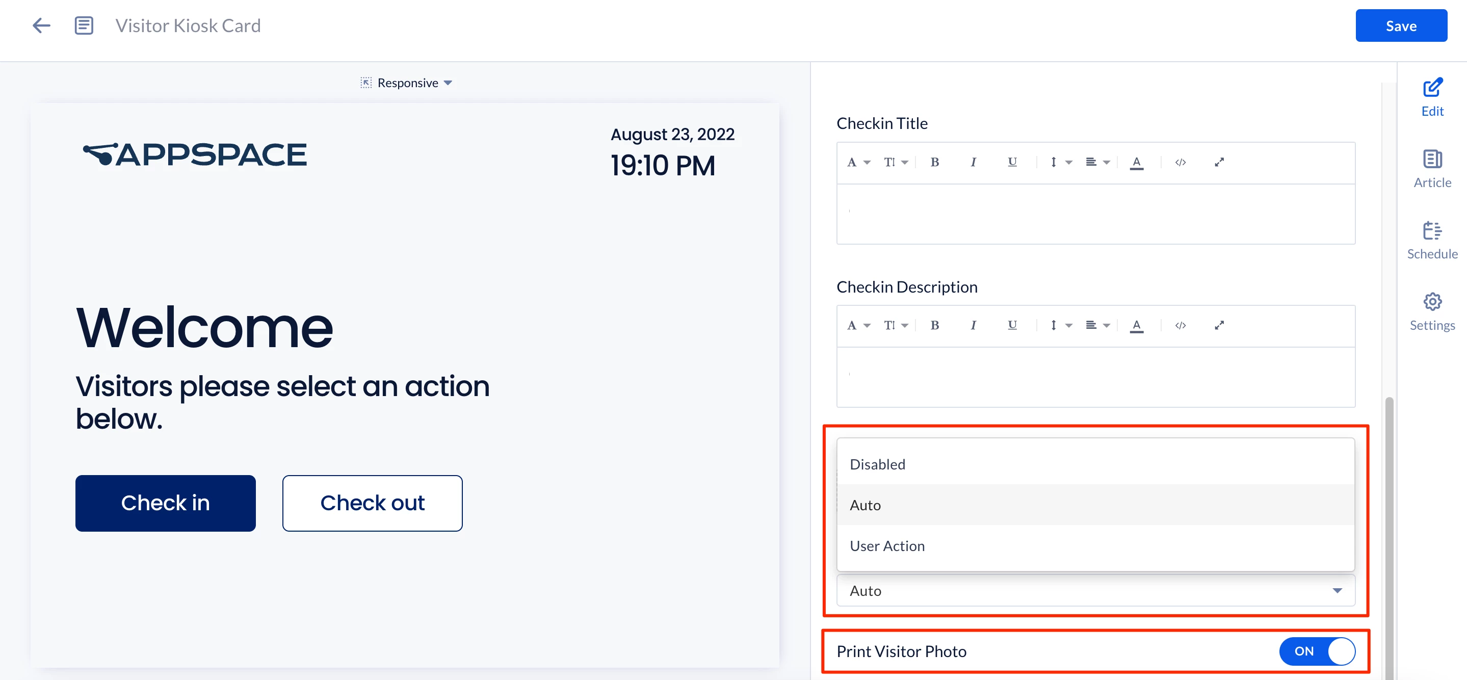

    •  Select your preferred Print Badge options:
      • Disabled: If you select disabled, the print badge button will not show when you check-in.
      • Auto: If you select auto, after you check-in the badge is printed automatically without the need to click the print badge button.
      • User Action: If you select user action, once you check-in the print badge button is shown, you will need to click the print badge button to do the printing.
        For the Print Badge Auto and User Action options, users can turn ON or OFF the option to Print Visitor Photo.
        Printing functionality is currently supported on devices running iOS 26, Android 12 (or later), ChromeOS, and Neat OS when configured with Brother QL Series printers (please refer to the Prerequisites section at the top of this article for the entire list of devices).
        If a non-supported device is used for the kiosk, the Disable option must be selected.

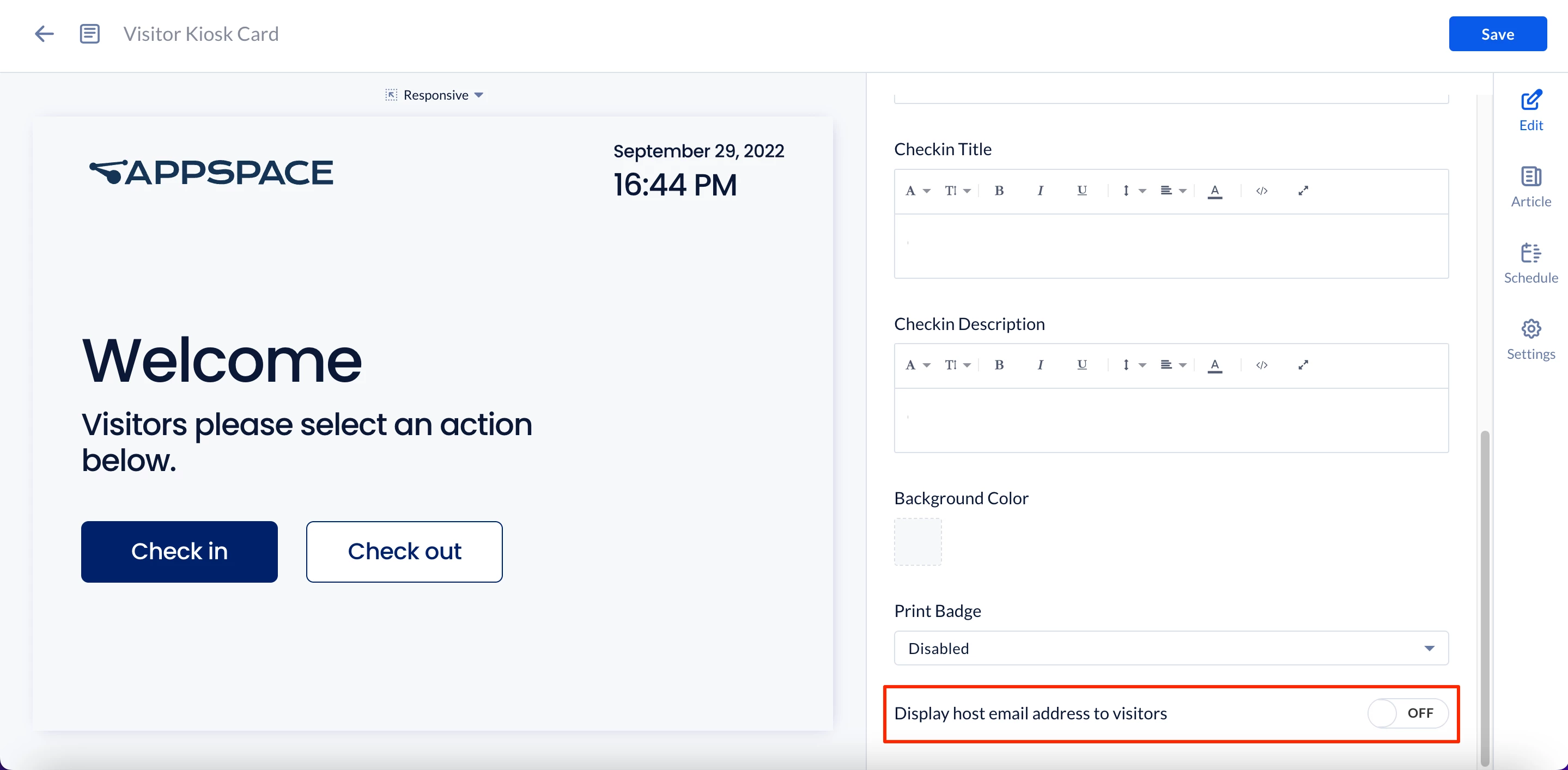

    • (New) Set the Show only users from this location option to ON or OFF to determine whether only hosts whose location is set to the selected building will appear in the search results when a drop-in visitor searches for a host.
    • Set the Display host email address to visitors option to ON or OFF to determine whether the host email address is shown or hidden when a drop-in visitor searches for a host.
