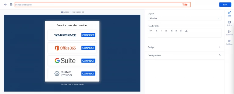

- Click Workplace from the side panel, and click the Schedule Board card.
If you are unable to locate the card content, you may use the Search bar, Filter By Content Category or Tags, to further narrow down the card content that you are looking for.
- Enter the Title for the card content, as this also acts as a filename when displayed in the Library. This is a mandatory field.
- In the Card section, select and authenticate your preferred Calendar Provider:
- Appspace
- Click CONNECT, and proceed to Step 6 below.

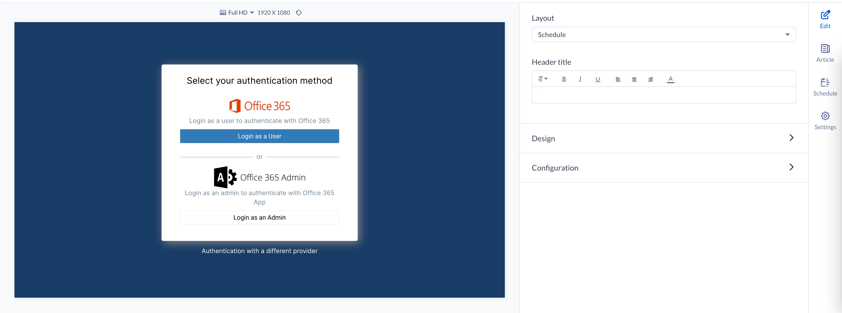

- Office 365
- Click CONNECT, and select the authentication method of your Booking Account.
- Login as a User – O365 Room Booking Service with User Privileges
- Login as an Admin – O365 Room Booking Service with Global Administrator Privileges
- In the Authentication window, enter the Booking Account credentials to authenticate the Schedule Board card.
Please contact your Microsoft O365 Administrator for credentials. Some large organizations may have one account for each room.If you encounter authentication issues while setting up the Office 365 integration with user privileges on Azure, please ensure the Azure Admin Consent Requests have been configured by following the steps in the Configure the admin consent workflow (preview) article: https://docs.microsoft.com/en-us/azure/active-directory/manage-apps/configure-admin-consent-workflow
- Once the authentication is successful, proceed to Step 6 below.

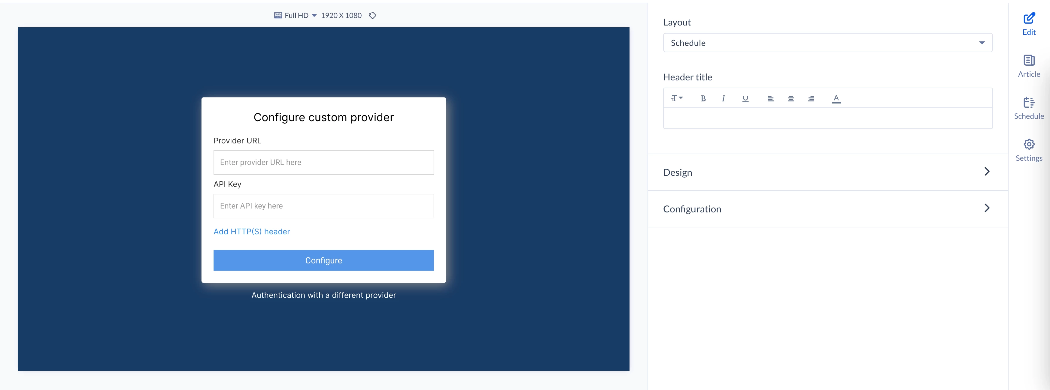

- Custom Provider
- Click CONNECT.
- Enter the Provider URL and API Key of the custom calendar provider, and click Configure.
- Optionally, click the HTTP(S) headers to add the custom provider’s header and value, such as the authorization credentials.

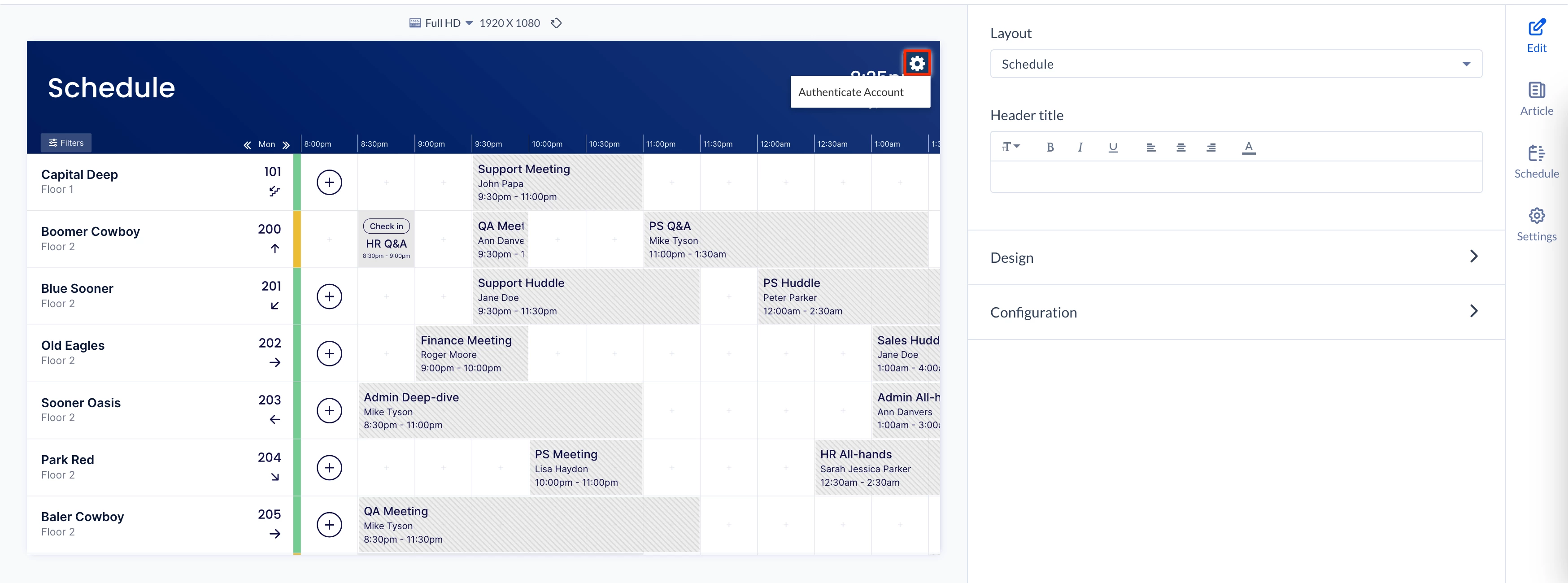

- Preview
- Click the Preview card in demo mode link if you would like to authenticate later.
The demo mode on cards, allows users to experience the design and functionality of the card prior to configuring it to a calendar provider. This includes displaying various booking statuses and performing bookings on the card itself.
- The preview pane displays the card. Click the Gear icon to change the displayed rooms, or to log out from the card.
The booking status of the meeting room is only a preview, and is not indicative of the real status in this preview. If the card is in demo mode, clicking the Gear icon will display the Authenticate Account option, which will allow you to authenticate the card with your desired calendar provider.

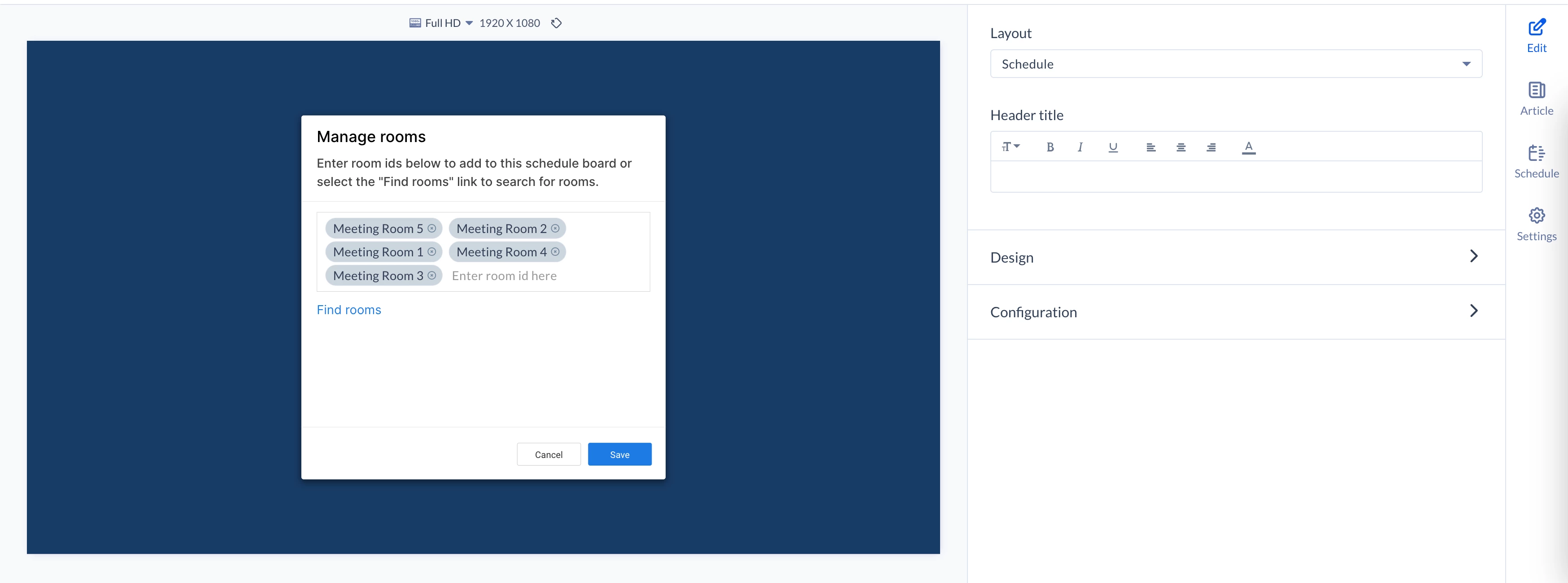

- Appspace
- In the Manage Rooms window, find and select the resources (meeting rooms) you wish displayed on the Schedule Board card.
- Once done, click Save.

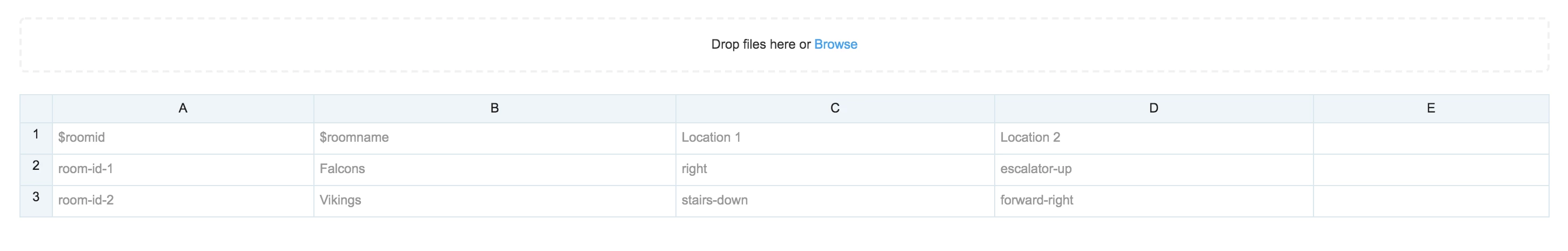

Configure Simple Wayfinding
- In the Schedule Board card, click the Edit tab.
- In the Configuration section, click the Add Data button for Room mapping.
- The table will be auto-populated with the Room IDs and Room Names of the selected resources (meeting room in Microsoft Office 365) displayed on the schedule board, in the first and second columns respectively, starting from the second row onwards.
The Room ID (Resource ID) is the Resource ID of your Appspace Reservation resource; refer to the Edit Resource section above.
- You may populate the table using one of the following methods:
- Manually enter the data.
- Copy and paste data from an external table.
- Import data from an Excel spreadsheet (.xlsx).
If you’re pasting data from an external table, or importing data from a spreadsheet, please ensure that the Room IDs, Room Names, and Headers are exactly as displayed in the Room mapping table. We recommend copying the data from the Room mapping table to your external table or spreadsheet first, before pasting or importing it back.
- Enter the schedule board device(s) locations in the first row, starting from the third column onwards of the table.
- Finally, enter the directions of the schedule board device in relative to the resource (meeting rooms) in the third column (and onwards).The following directions are supported:
- left
- right
- forward
- forward-left
- forward-right
- backward
- backward-left
- backward-right
- escalator-up
- escalator-down
- stairs-up
- stairs-down
- Once complete, click SAVE.
