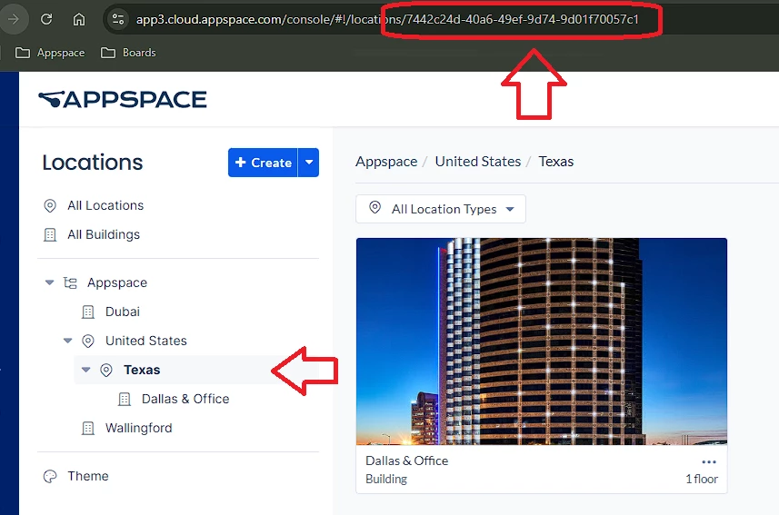

Assuming you’re making a call to /api/v3/channeldirectory to simply list all channels:
This API call in particular needs some data up-front. At a minimum it requires the parameters networkID & pageCount
In Postman this can be parameterized as such:
https://api.cloud.appspace.com/api/v3/channeldirectory?includesubnetworkchannels=true&networkid={{networkID}}&limit=0&pagecount=1
You can more easily fetch the networkID you want to search by going into the console and going to Locations, click on the network in question, then review your browser URL header.
