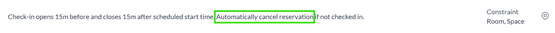

  2. Check-In Requirements
    • The auto-cancel action is triggered if the user fails to check in within the check-in window.
    • The auto-cancel for check-in expiration only happens when the timeout action is configured to auto-cancel in the check-in rule.

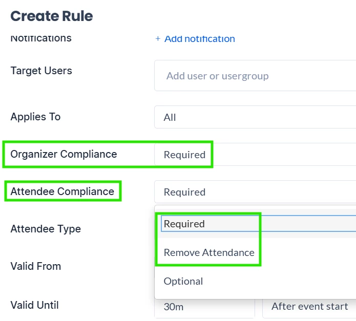

  1. Checkpoint Failure
    • The attendee or organizer fails to complete the checkpoint.
    • This depends on the compliance type that is set for the attendee and the organizer.
      • For the organizer:
        • Required: Will cancel the event if the organizer fails to complete the checkpoint.
      • For the attendee:
        • Required:
          • If the attendee has accepted the invite but does not complete the checkpoint, the event will be canceled.
          • If the attendee has not yet accepted the invite and does not complete the checkpoint, the attendee will be removed from the event.
        • Remove Attendance: Will remove the attendee from the event if the attendee fails to complete the checkpoint.
        • If no attendees are involved in the event anymore, the event will be canceled as well.

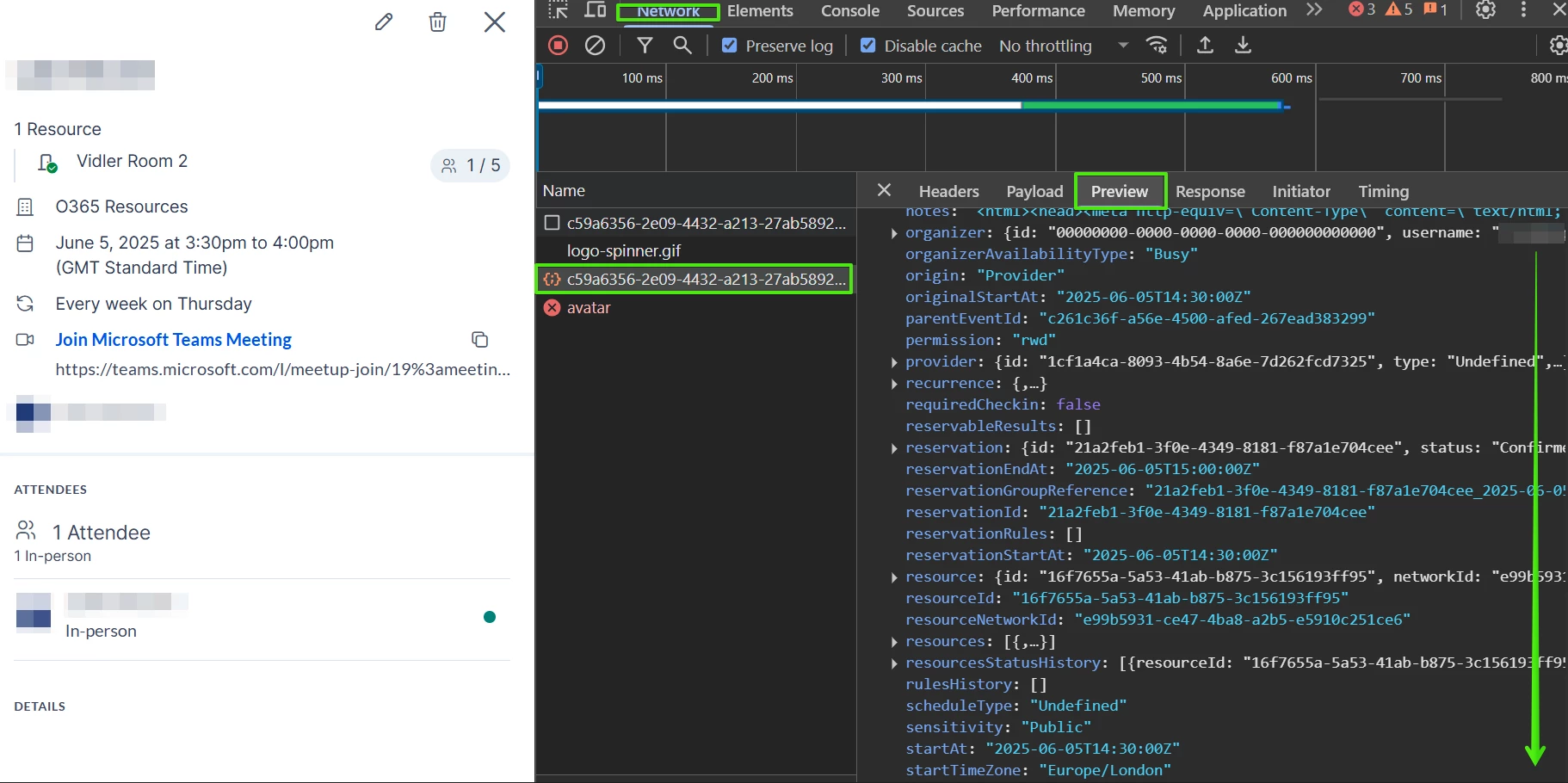

To investigate why an event was canceled:
  1. Access the Event Data
    • Open the developer tools in your browser.
    • Navigate to the Network tab.
    • Select the event within the Appspace.
  2. Locate the Relevant Request
    • Look for a GET request with a URL similar to this:
    • 9c024b2c-5c1a-4f26-8db6-bf58e700a055?includesourceobject=true
    • Alternatively, search for "reservation/event" in the Network tab to filter and locate the request more easily.
  3. Inspect the Request Details
    • Click on the request and check the Preview or Response tab.
  1. Review the Relevant Fields
    • statusHistory Field:
      • This field contains the cancellation history, including the reason and the updatedAt timestamp.
      • If the event was canceled due to a conflict, this field should also include conflict history.
      • Refer to below example under Example of event canceled due to conflict.
