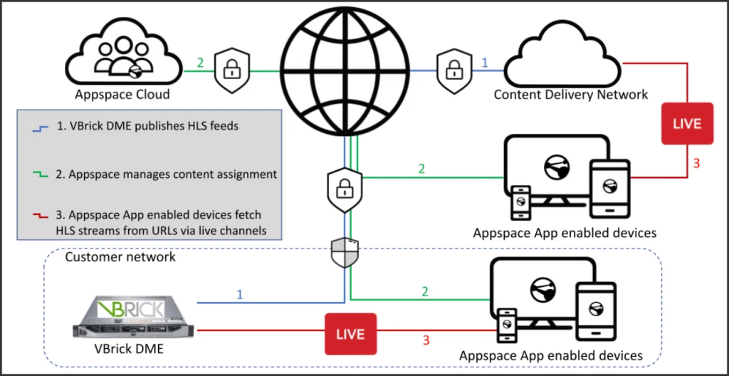

High-level Architecture Diagram
A deployment using both Appspace and Vbrick might look something like this:
In this scenario, a local Vbrick DME is used to distribute internal and external (via CDN) HLS sources. Devices running the Appspace App are registered to the Appspace cloud, and Live Channels are published to these devices. Registered devices individually connect to an HLS source using the URL.
Both Appspace and Vbrick offer cloud-based and on-prem deployment scenarios. The architecture shown above assumes the two most common choices: a cloud-based Appspace deployment and an on-prem Vbrick deployment.

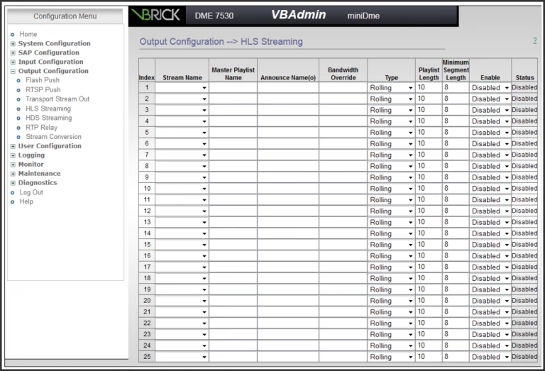

  1. From the Vbrick DME interface, it’s a simple process to set up, as seen here:
    https://www.vbrick.com/doc/DME/v344/AdminGuide/wwhelp/wwhimpl/common/html/wwhelp.htm#context=Admin&file=DME_7.html
  2. Once the HLS sources are set up in the VBRick DME, the .m3u8 files generated can be made available in two ways:
    • Internal access: The DME will present a URL that can be reached from within the internal network. This will typically follow the following convention:
      http://<dme_ip_address>/HLS/<stream_name>/playlist.m3u8
    • External access: Given the choice of CDN, it’s possible that there won’t be a static URL provided to reference. It will be necessary to find the exact URL that points to the .m3u8 file for Appspace to playback the stream. The option to use an external source is essential for security and to more effectively handle devices requesting access to an HLS source from outside the customer network.
      This means that since a stream’s URL is not fixed, it would require the exercise of pulling the .m3u8 direct URL each time.
