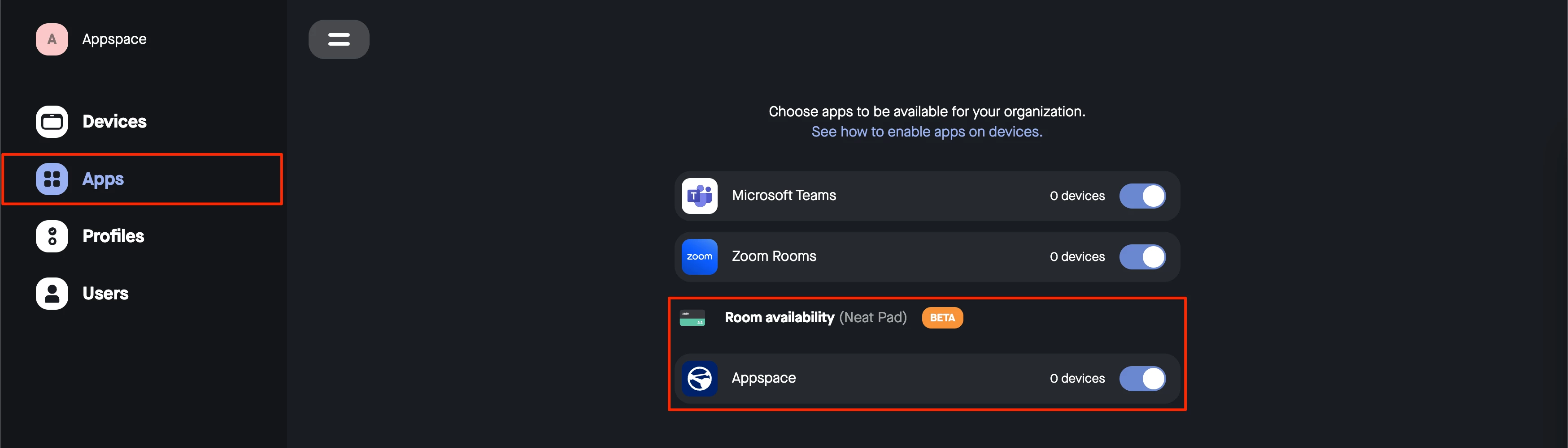

  2. Click Apps, and under Room availability, ensure the Appspace toggle is Enabled.

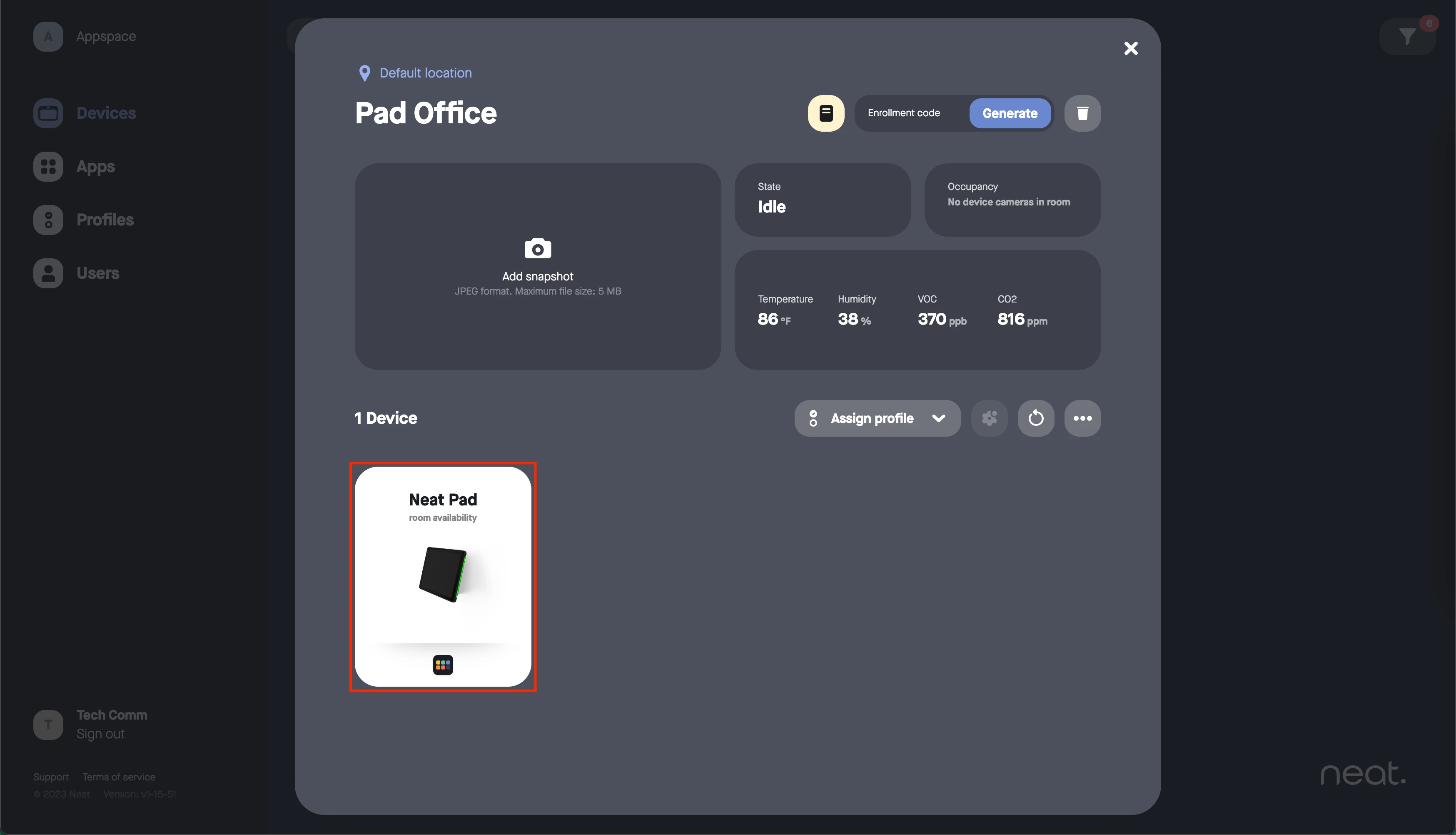

  3. Next, click Devices, and select the location of the Neat device.
  4. Select the desired Neat device, and navigate to the Device Settings section to perform the following configurations:
    • In Apps, select the Appspace app.
    • In Software, ensure the Channel is set to default, and the Enable Automatic Upgrades toggle switch is enabled.
  5. Once done, proceed to Register the Neat device with Appspace via the 6-character code displayed on the registration screen.
