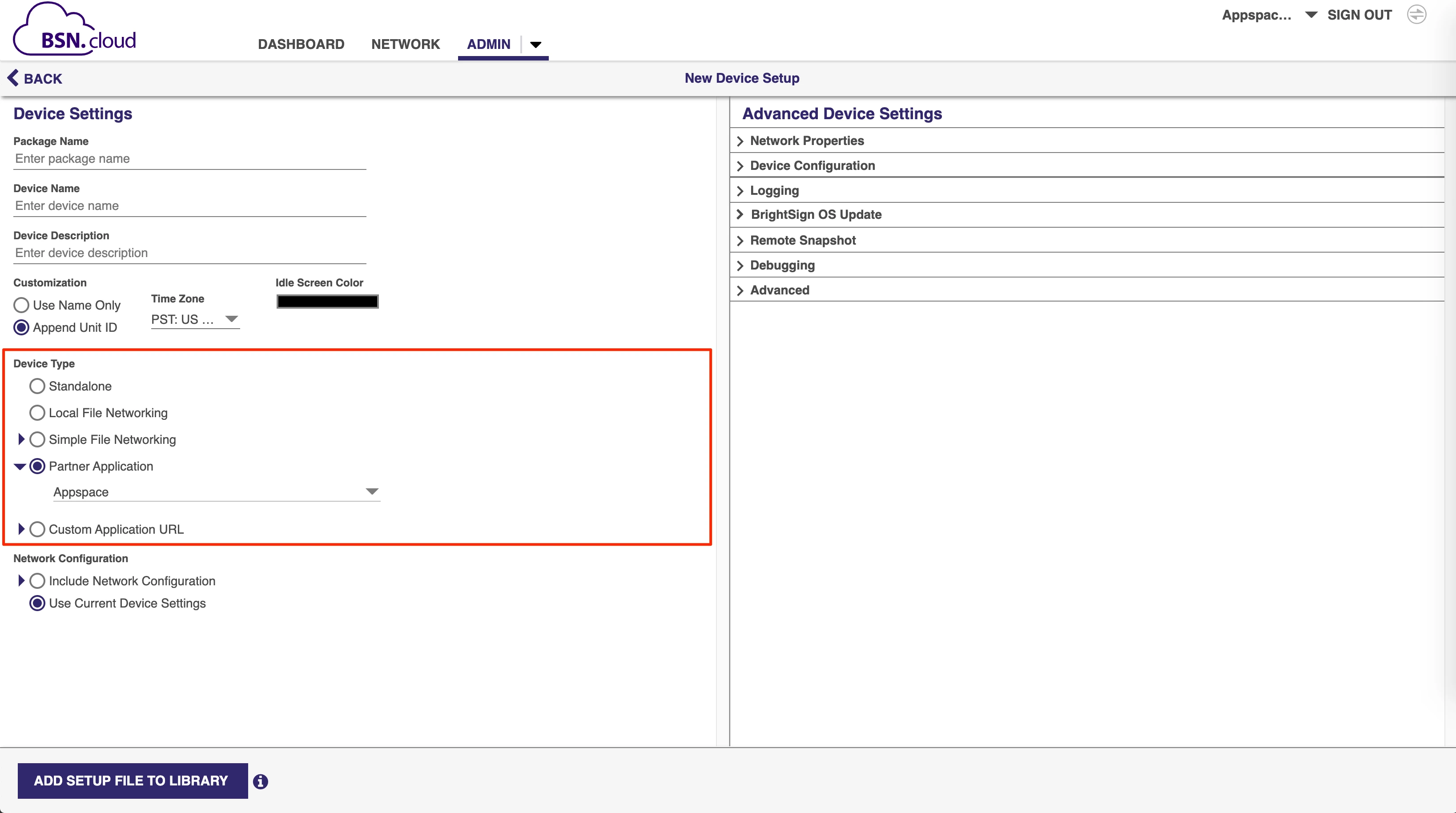

- Log in to BSN.cloud (https://control.bsn.cloud/) using your BrightSign credentials, or create a new account.
They will be an option to download the dedicated app for Windows or Mac, or to continue via the browser. Choose to continue via the browser.
- Please follow the instructions from the BrightSign documentation. Do take note of the following:
- In the Prepare Your Players For The Control Cloud section:
- In Step 6, select Partner Application as the Device Type, and select Appspace from the drop-down menu.
