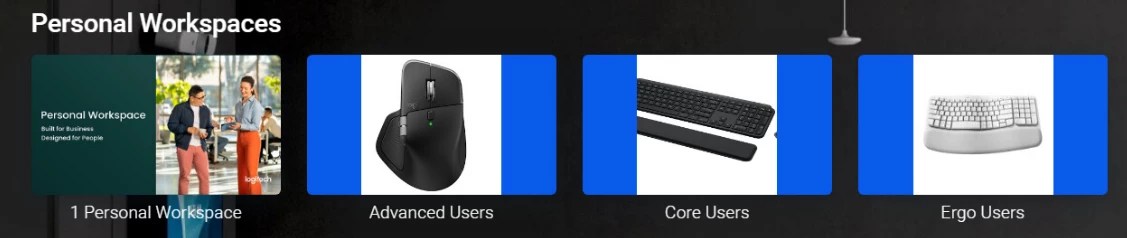

Hey ​@aberns, There’s currently no way to convert an existing Playlist Channel to a new Signage Channel. That option is planned, but the Signage Channel rollout is being handled with a phased approach starting with multi-zone.
I dug back through some of my notes and was able to find that the Channel Browsing thumbnail resolution is 350x200.
If the thumbnail still isn’t showing up (or isn’t showing up properly), then I’d definitely advise a support ticket so that our team can dig in. If no one reached out per ​@Dawn Wayland ‘s message please let us know!

​@Will White I understand on the thumbnail size, thank you for clarifying that. We are working through a ticket on this.  It still doesn’t resolve the issue of why I can only get thumbnails to work on a Multi Zone, and not a regular signage.  And when I do get a thumbnail, it looks like this, which conflicts with your resolution size, because it is obviously looking for a 16x9.  This is a channel group.  The first one is a digtral signage, and it has an thumbnail with it.  the others are multi zone, that has a 16x9 thumbnail that crops (which appears to be 350x200), but why the blue boxes?  Attached is my device properties.  Even if I upload a 250x200 image to the 1 Personal Workspace, I still only get the first slide in the channel.
looking for a 16x9 image.
