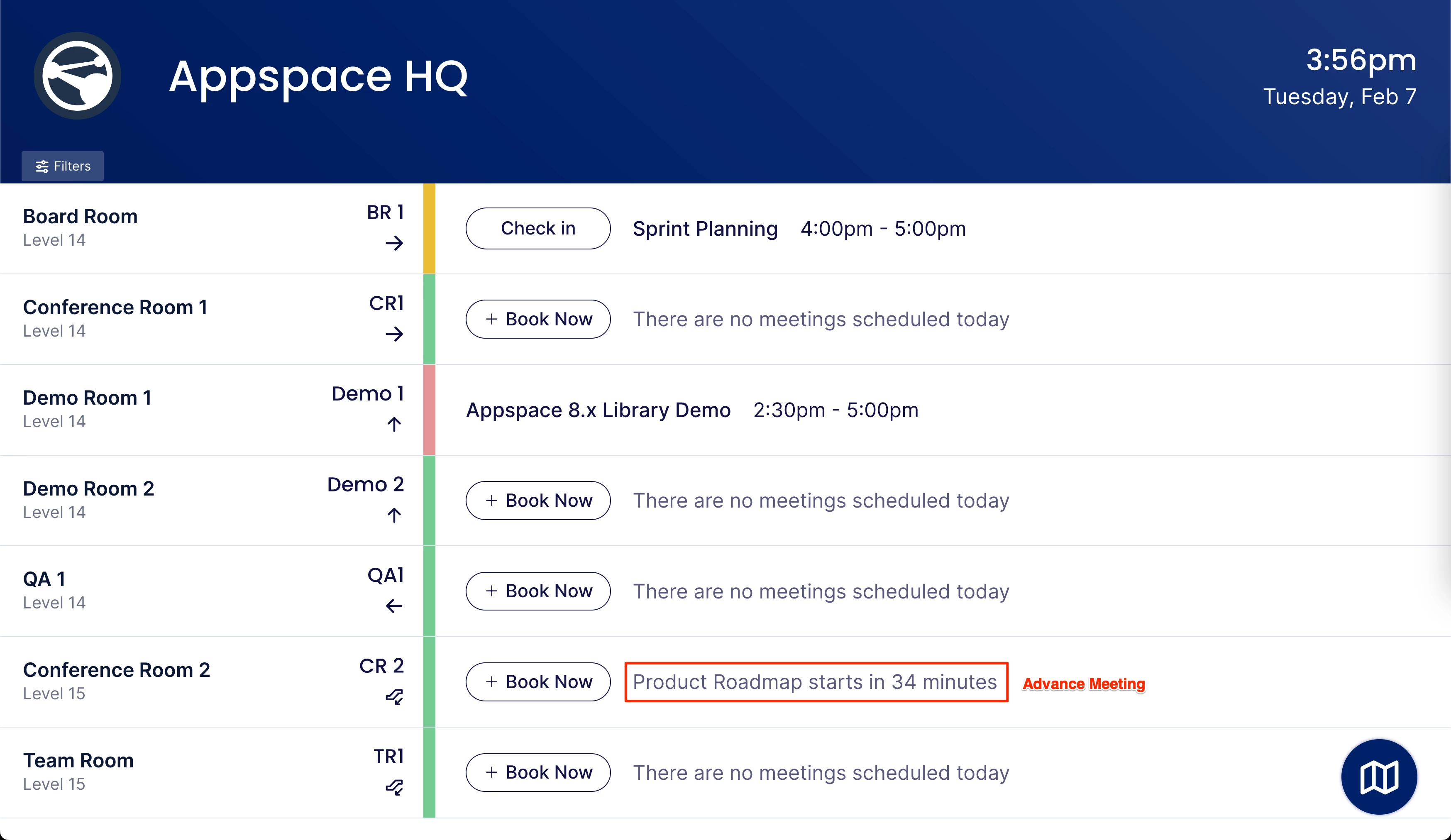

The Current events view provides a simplified version of the Schedule view, where it displays only the current and next meeting, for multiple rooms.
  • If Maps is enabled on the Display options, users can click on the room name, and the location of the room is displayed on the floor plan.

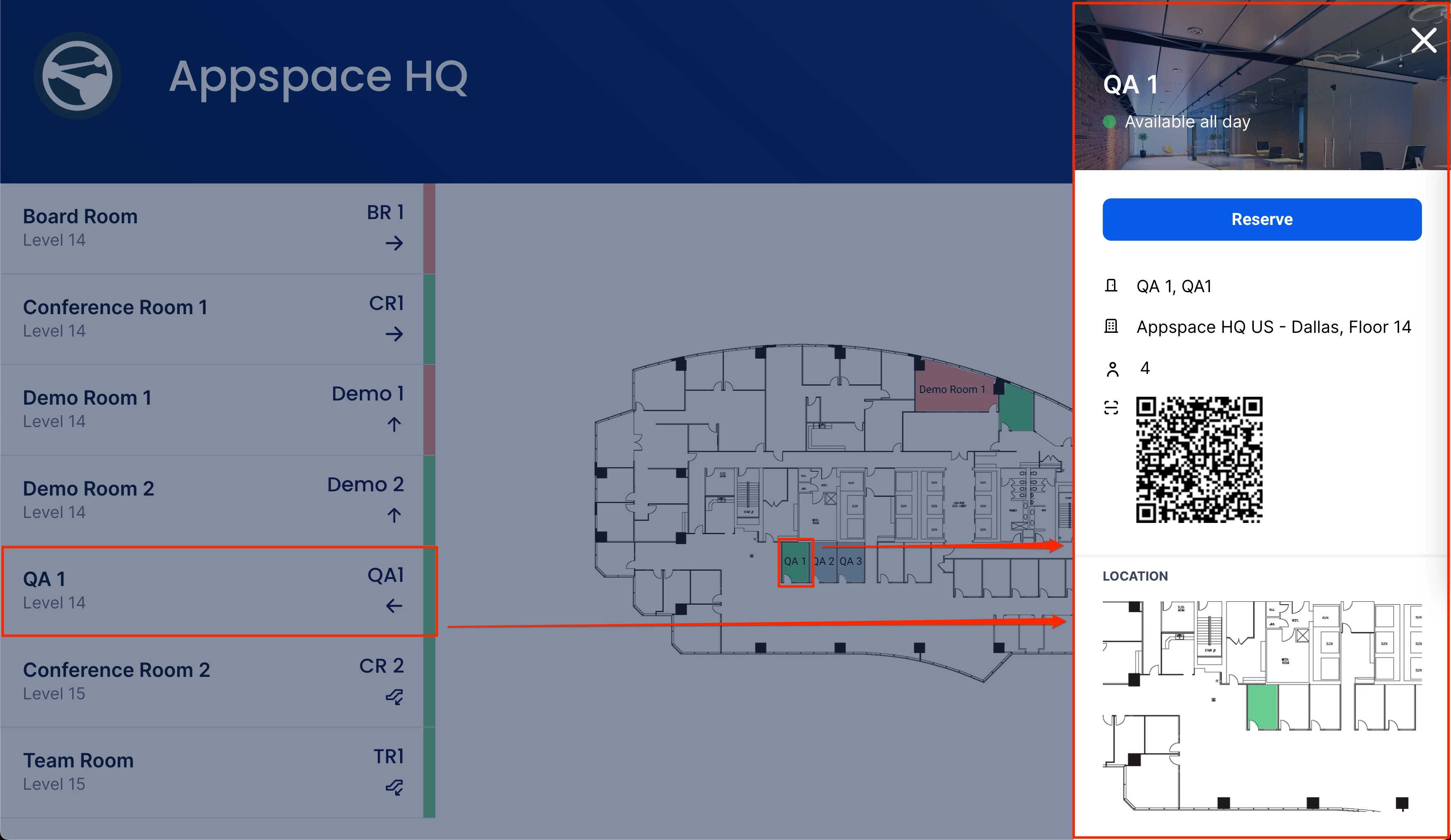

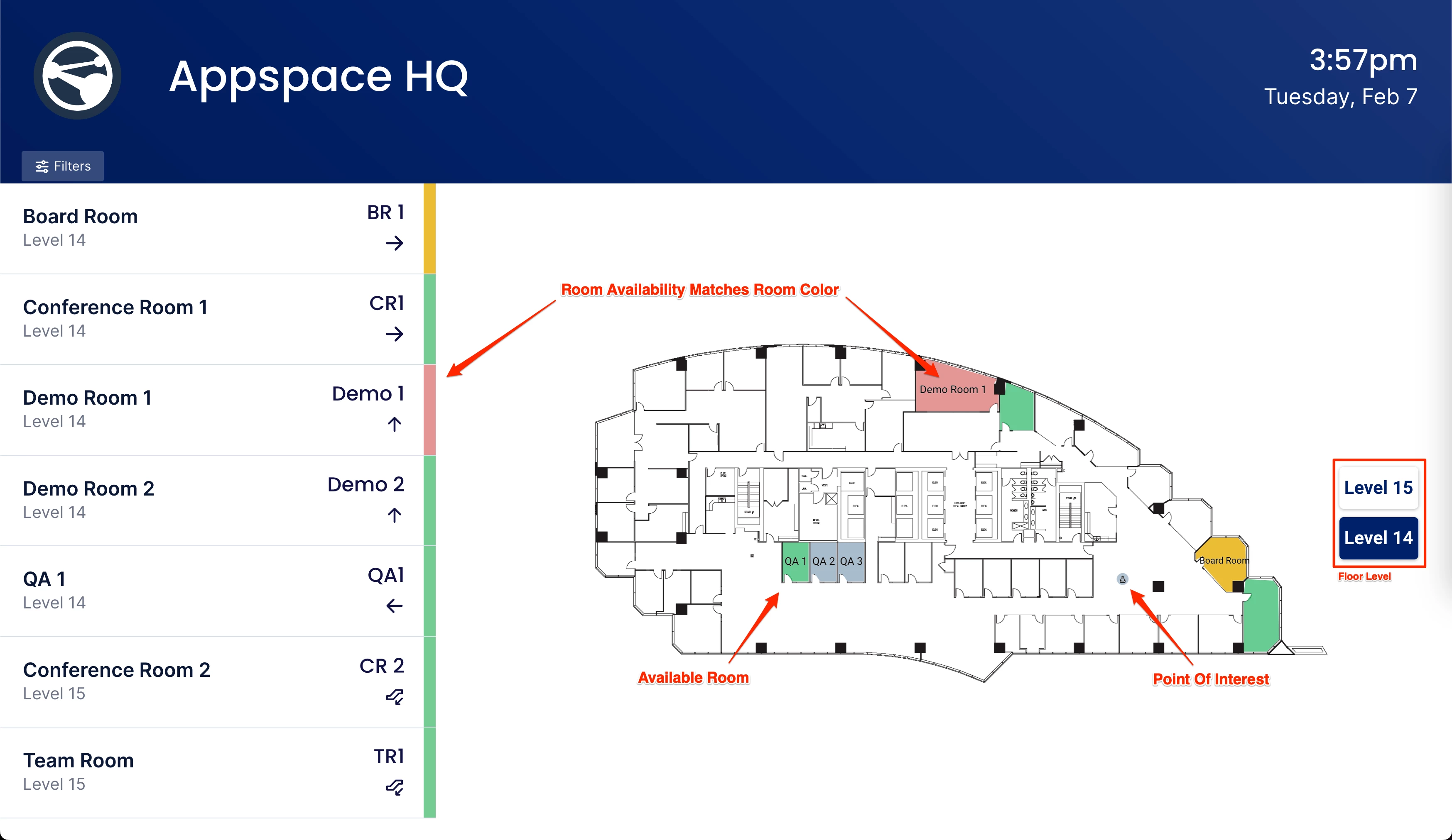

Map View
The Map view provides a simplified version of the Schedule view, while providing a graphical view of the availability and locations of the rooms based on floor plan.
  • Users are able to quickly identify the room’s availability and location instantly, as the room color on the floor plan reflects the current room status:
    • Green – Room available for booking.
    • Red – Room is occupied.
    • Yellow – Room is waiting to be checked in.
    • Grey – Unmapped resources, rooms, or POI (Point of Interest) that can’t be booked.
  • Users can click on the room name, or the location of the room in the floor plan to view information, or to make a booking.
  • If a building contains many floors, users can select the floor to identify the available rooms or resources located on that floor.
    • By default, the map will display the First/Ground floor as the default floor of the building, unless the “You are Here” indicator is configured, then that floor will be displayed on the map when a user first accesses the Schedule Board card.
      • First/Ground floor can be configured as Floor Level 0 in the location setting for the floor plan.
      • If the Floor Level is not set, the First/Ground floor will be sorted (descending) accordingly based on the floor description.
    • The map will display all resources within the floor first in alphabetical order, and then followed by the rest of the resources in other rooms.
    • If there are more than 2 maps with the same Floor Level configured, for instance if the “Level 15” office area, and “Level 15 Parking” space area are on the same Floor Level, then these floors will be sorted and displayed based on their floor names.
  • When a booking is made or canceled, the room color on the floor plan reflects the current room status.
  • Users are able to utilize the Filter by option in order to filter rooms based on Status and Floors. (Filtering support for Facilities and Zones would be coming soon)
    • Once a user selects a floor(s) to be filtered, the resource list on the left panel will automatically display all resources within the floor(s) in alphabetical order.

  • Multiple room information – the room name and status indicating if the room is available, offline, or occupied is displayed.
    • Available – when the room is available, the card displays the Book now button, and the default display color is green (unless if the color was changed earlier during the card customization process).
    • Booked – when the room is occupied, the card displays the meeting name, and the default display color is red.
    • Check in – when a meeting is about to start, the card displays the Check in button, and the default display color is yellow.
  • Meeting information – details of current meeting and upcoming meetings for the day.
  • Filter function – meetings rooms may be filtered to only display available, check-in, and occupied meeting room statuses.

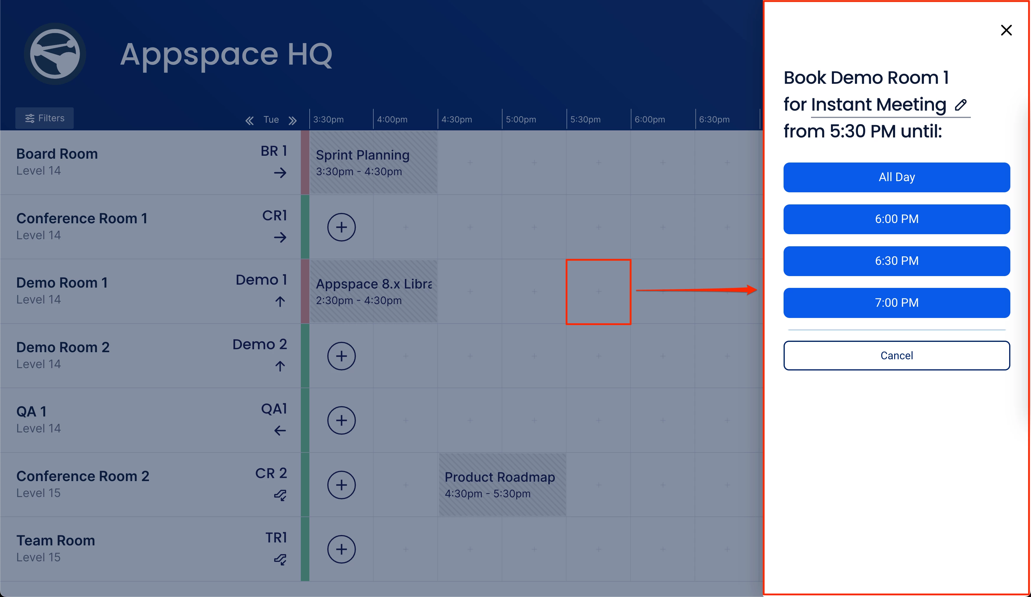

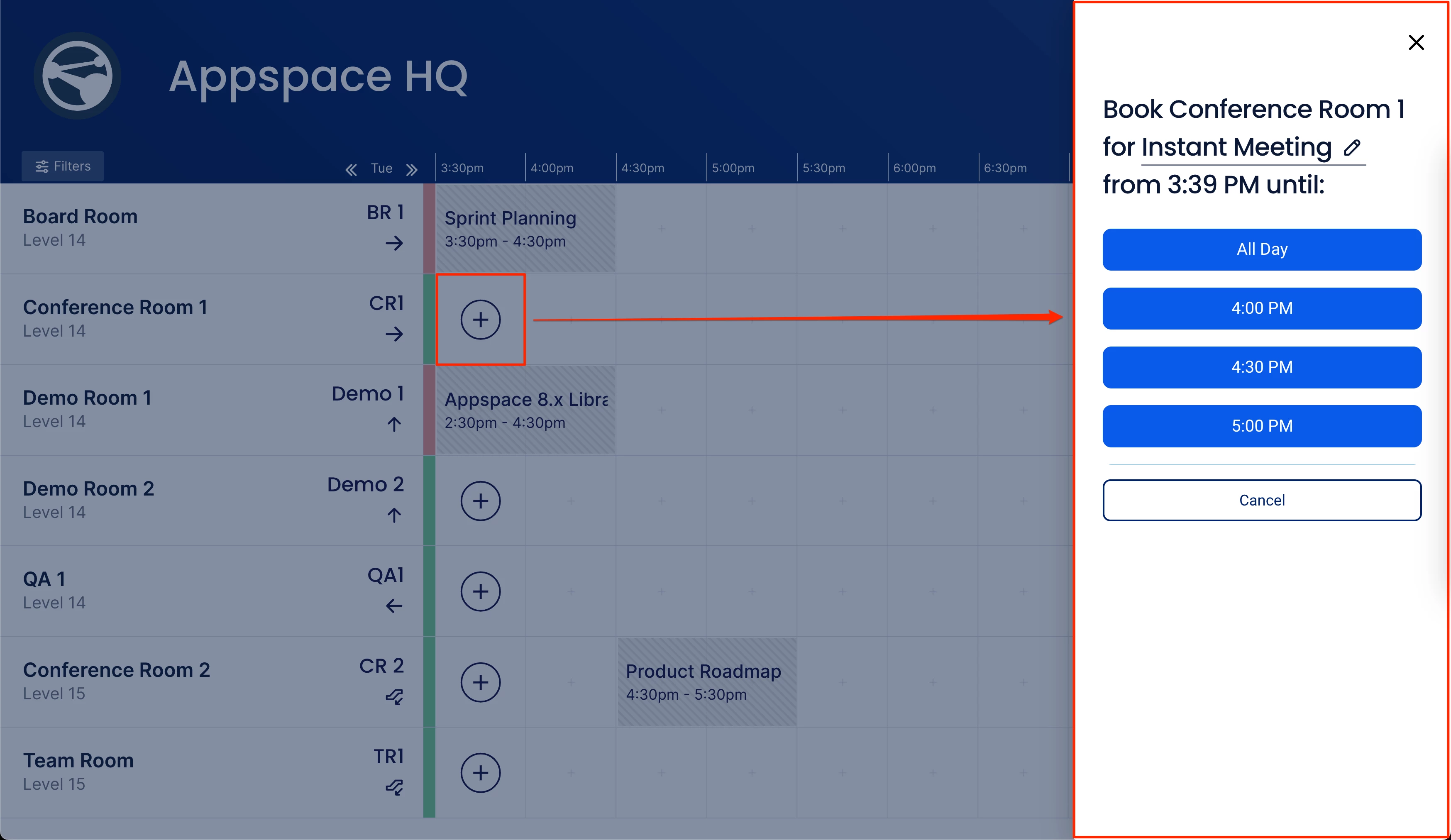

    • Book now - You may book a meeting room instantly when the room is available. To book a slot from the current time:
      1. Click the large Plus icon, or Book Now (if in Current events view) on the selected meeting room.
      2. Select the end time of the meeting by clicking one of the available end time slots. Choosing one of the time slots will book the room from now until the time slot chosen. These time slots will only be available if the Show available time slots option was selected during the card configuration.
    • Advance Booking - To make an advanced booking:
      1. Click the smaller Plus icon, or Book Now (if in Current events view) on the selected meeting room.

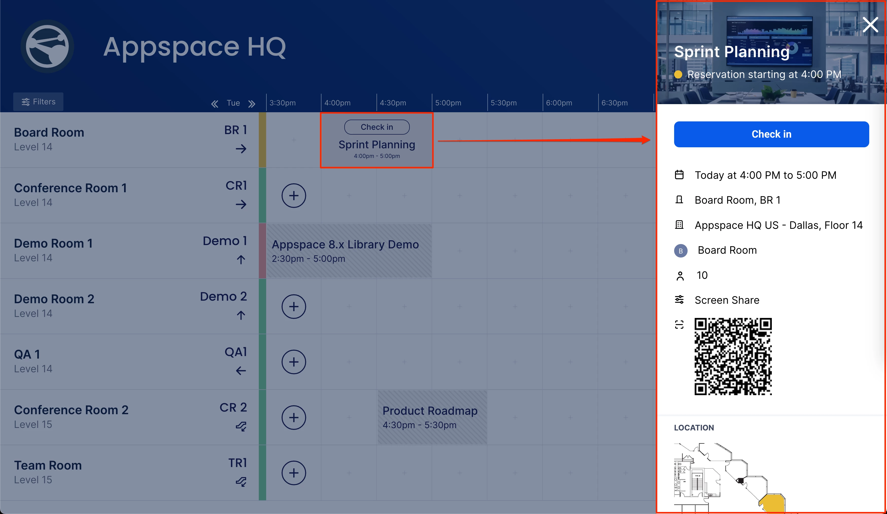

    • Check-in- To check-in a booking:
      1. The Check-in button becomes available on the app 10 minutes before the start of the meeting until 10 minutes after. If no one performs a check-in within that 20-minute window, the meeting room reservation is automatically canceled.
      2. Click the Check in button, 10 minutes before or after the meeting starts.

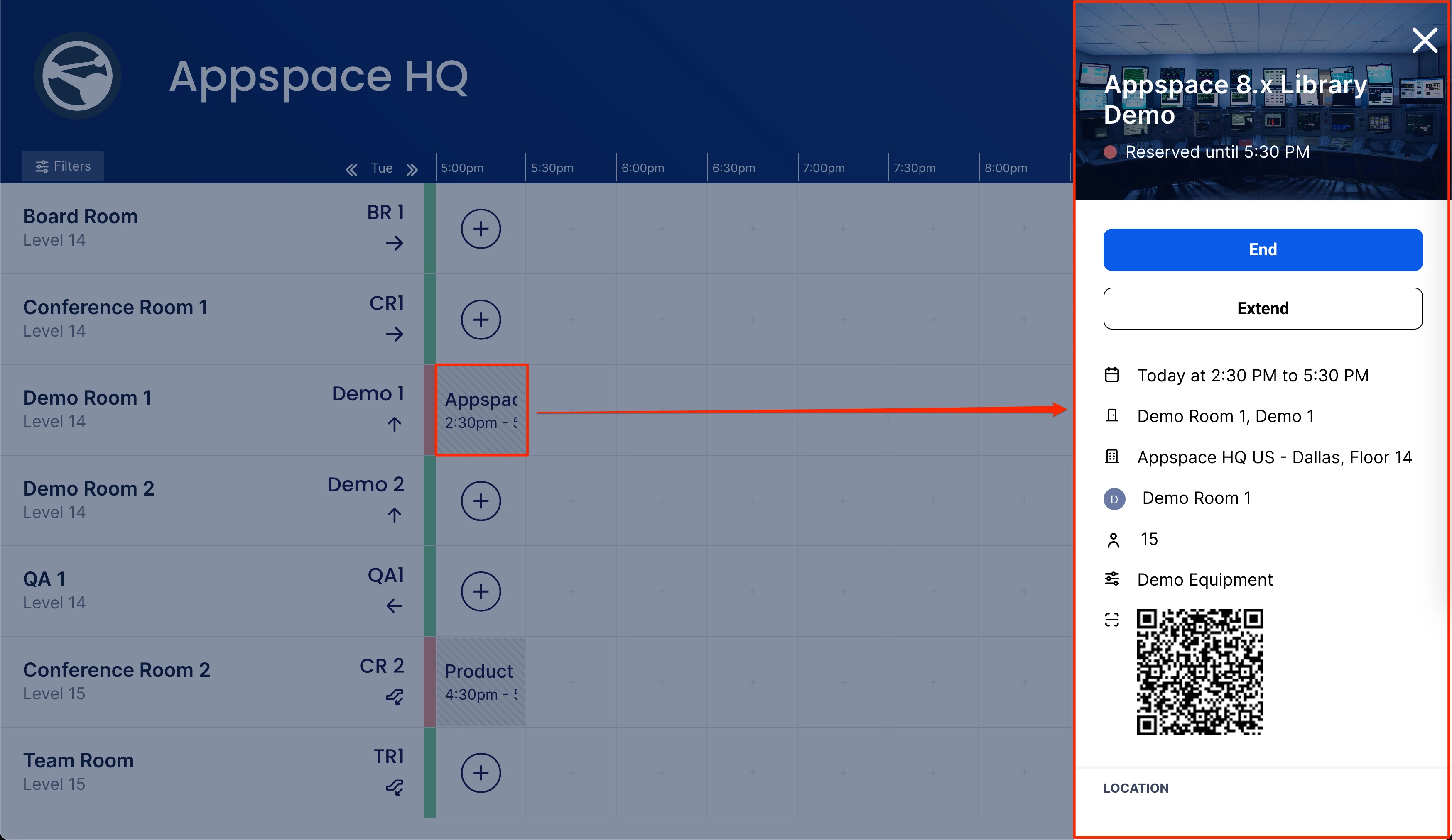

    • Extend meeting - You may choose to extend the booking of a meeting room that is already in session, if the room is available after your slot.
      1. Click the ongoing meeting, and click Extend meeting button.
    • End meeting - To end a meeting immediately while the meeting is in session.
      1. Click the ongoing meeting, and click the End meeting button.
