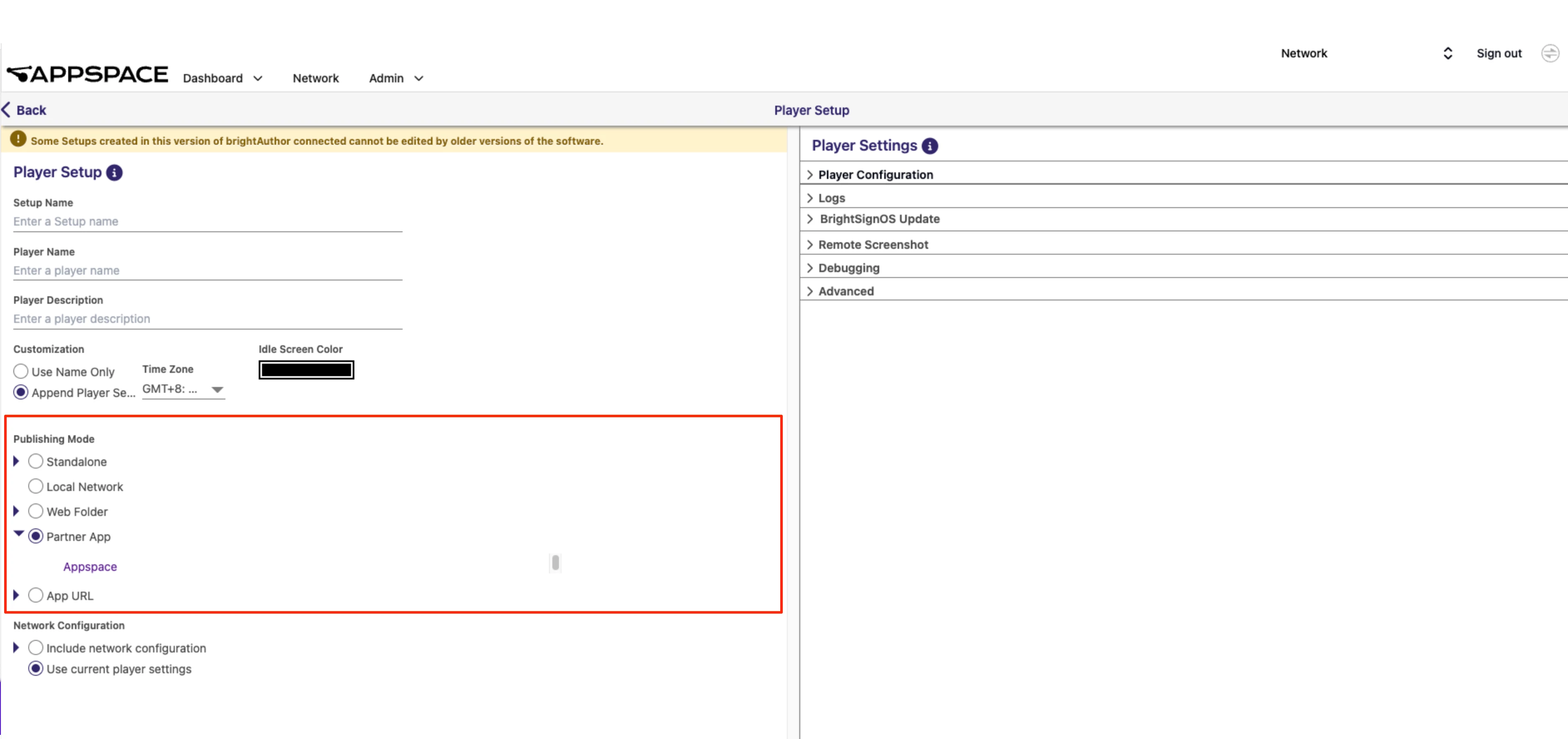

    • In the Prepare Your Players For The Control Cloud section:
      • In Step 6, select Partner Application as the Publishing Mode.
